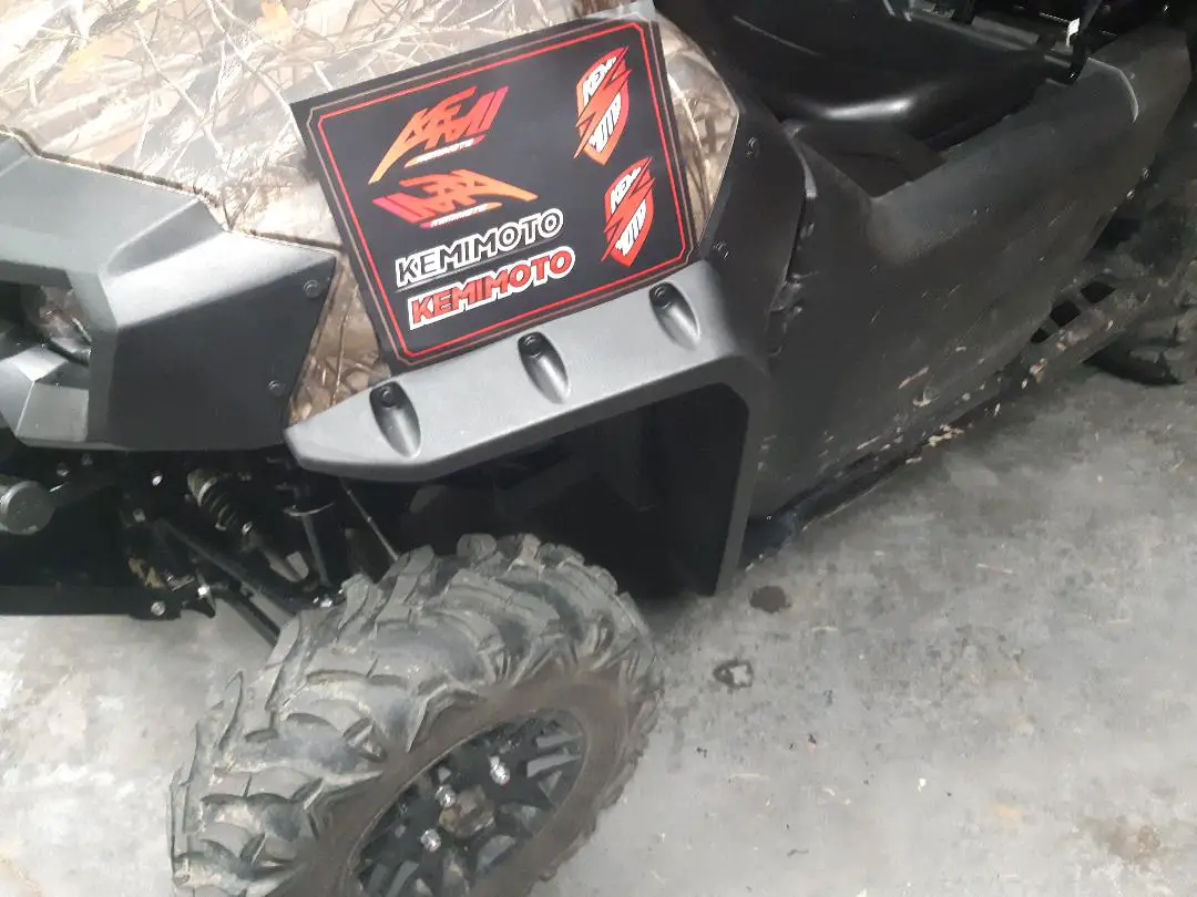

For under the hood. I custom built a shelf to hold the fuse block and stinger relay. To the right I mounted my winch relay. The stinger is ran off a key on power harness that I had purchased from this site that plugs into the back of the 12 volt accessory plug. Ran all the wiring through nylon wire loom and heat tubed all the wire ends for a cleaner look.
