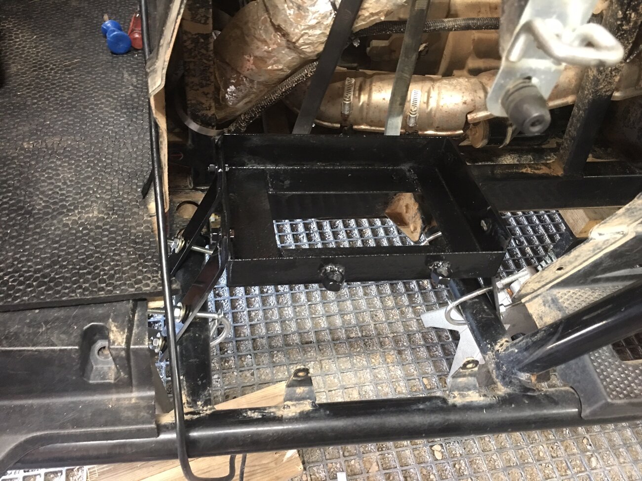

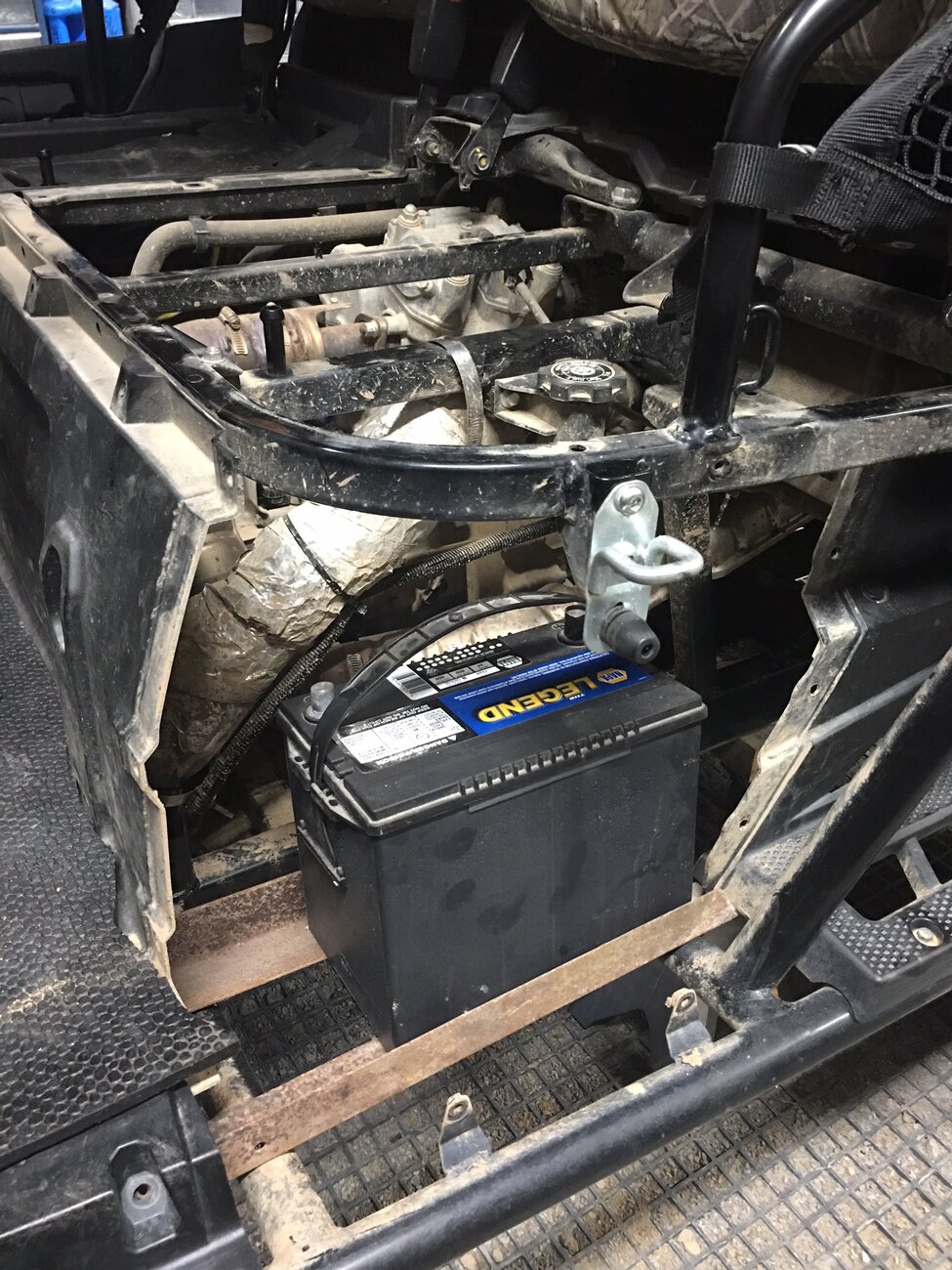

I never had to move mine.I run a full size auto battery. Here make it like this. Easy simple

Hi thanks so I am planning on making a mount like in your first pic and put it in a plastic battery box but want to be able to get at it to replace without removing the panels to get at like like your showing. Curious how muddy/messy does the battery get out in the open like that?

Unless you are running in mud deep enough to come through the doors it stays pretty clean. Just dusty steam spray that wipes off with a towel when you check oil.
