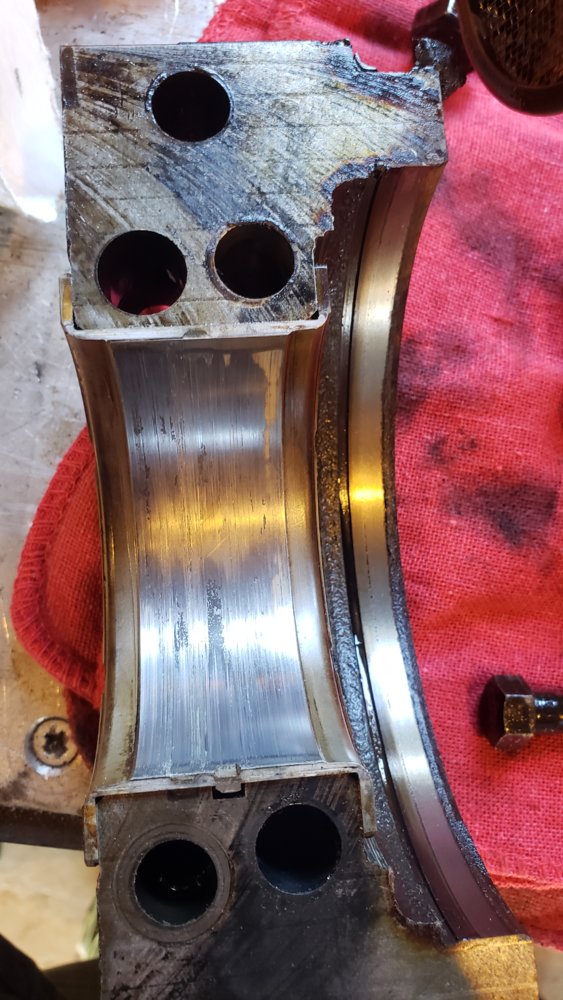

Well decided to pull the pan on the 7.4 and replace the oil pump. This is what the rear main bearing looks like!
20191215 145312 NOT GOOD
Now I guess I have to make a decision now.
Anyone have access to a deal on long blocks?
