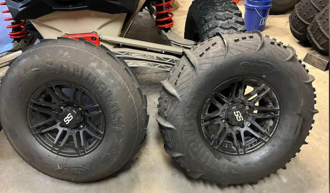

Along the same subject - I have a chance to get a full set of CST Sandblast tires at a very good price. They came off a can am and are 14" 4+3 wheels. (no idea of the actual mm offset). ITP SS wheels. Has anyone had any issues with clearance on a Talon R with wider tires in a 14? I have read before that I may need to file a caliper or something to clear. Thoughts? TX!
1645650331161
35,364
208,029
Along the same subject - I have a chance to get a full set of CST Sandblast tires at a very good price. They came off a can am and are 14" 4+3 wheels. (no idea of the actual mm offset). ITP SS wheels. Has anyone had any issues with clearance on a Talon R with wider tires in a 14? I have read before that I may need to file a caliper or something to clear. Thoughts? TX! View attachment 320882
Bet ITP would know the actual MM offset is on 4 + 3's
