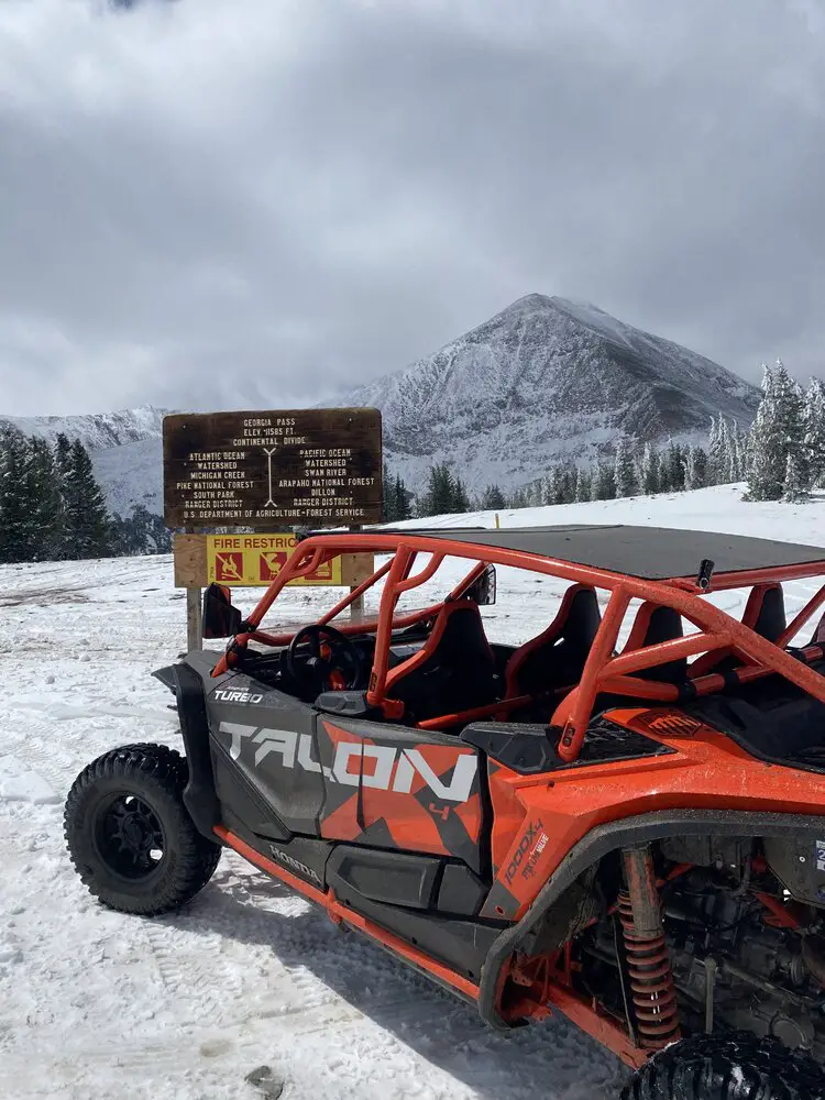

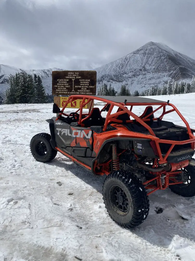

The Jackson racing turbo is the only way to go. The tunes I was referring too was Jackson released new tunes after the original ones to deal with the higher elevation isssues. I have no problems climbing at elevations and I have an AFR gauge and boost gauge installer. It’s Not running rich, in runs perfect. I will also add I was at the dunes and smoked all the can am turbos and Polaris turbos. The pic below Was at 11,585 ft clearly it was up hill to get there

New tune has been great at all elevations. And I live in Colorado and don’t run stock tires. AFR has been spot on. Who wants stock anything????? People always looking to complain about something unreal
View attachment 226936 View attachment 226937 View attachment 226938
Looks like you have the EVO slip on exhaust. One of the things that had me hesitant to pony up for the turbo is the stock exhaust requirement for the tune to work properly. At least that’s what Jackson and others say. Did you need to do anything special with the tune? I didn’t fix my machine up to put the stock Honda generator exhaust back on if I drop 5K on a turbo. I’m running the EVO now

Nope just plug and play with the tune no issues
