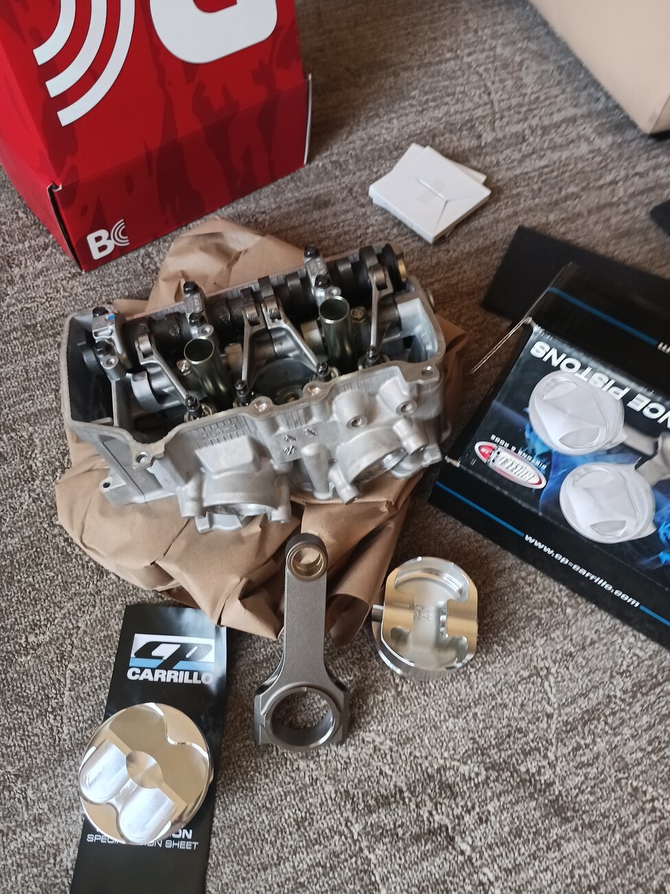

Good to know about the steel retainers. I’m also considering the BC turbo camshaft, but wondering how much difference it will actually make. I already have Jackson turbo, 9:1 wiseco pistons, PPEI bigger fuel pump, injectors, and tune, Trinity stage 5 exhaust.

You know what's funny about that. My GM finally got his head back and in the car with a BC Camshaft and Titanium retainers.
Afterwards he's talking to another fellow racer and learns BC contacted them and proceeded to say the Titanium retainers arent designed for "his application" and he should run the steel ones.
Funny, BC's own website recommended a spring kit for the cam their both using that includes Titanium retainers. Then trys to cover their ass by back pedaling.
Sounds like they have no idea what their selling or what should be used and where.
Typical customer service from the UTV world.
So, did you guys change out the retainers before running it or did you run it as is?

You need to run the springs!
I did not install the springs and so far so good, it runs great and pulls harder from a lower rpm all the way up. I will be doing a ported head and pistons in the future but being hospitalized 4 times over the summer has put a stop to pretty much everything that costs money.
