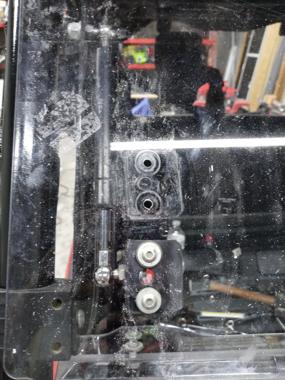

I have a SATV flip up hard coat. You can trim the top section to fit your new height. Only thing you'll notice is the old shock mount holes (3/16") after you relocate that mount.
👇 don't mind the dirtiness 😂😂 it cleans up nice

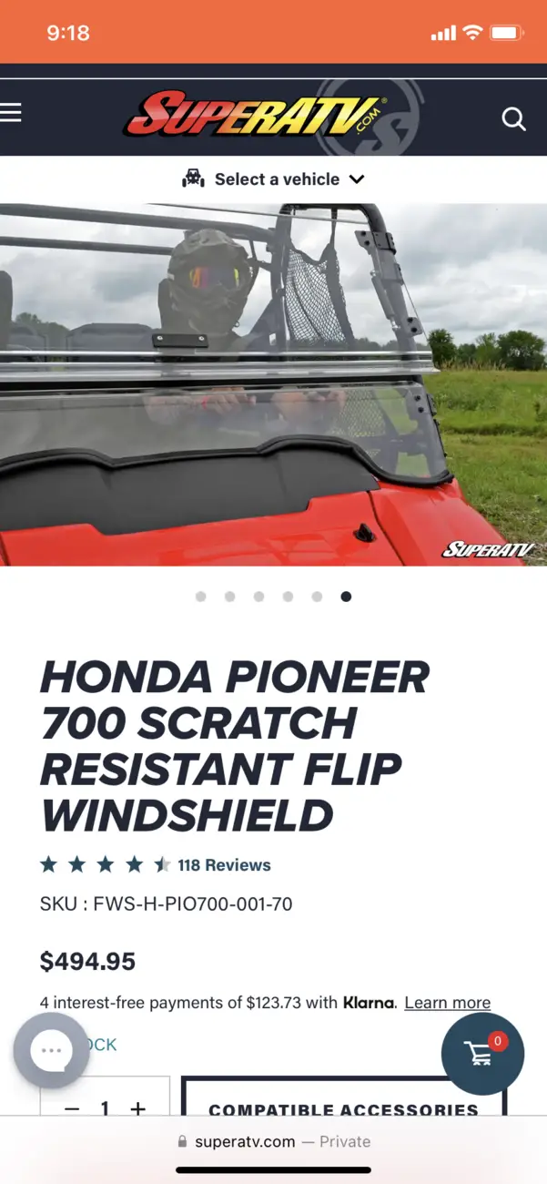

Yeah that's it, but for a P1K5
I actually used my skill saw with a 60 tooth blade, then a jig saw for the radius corners. I taped everything on both sides and cut very close to a solid pc of wood underneath to eliminate vibration. Also had the entire thing clamped down tight so there was no movement. It was a little scary just hacking intona $4/500 windshiels but it actually went easier then I thought
