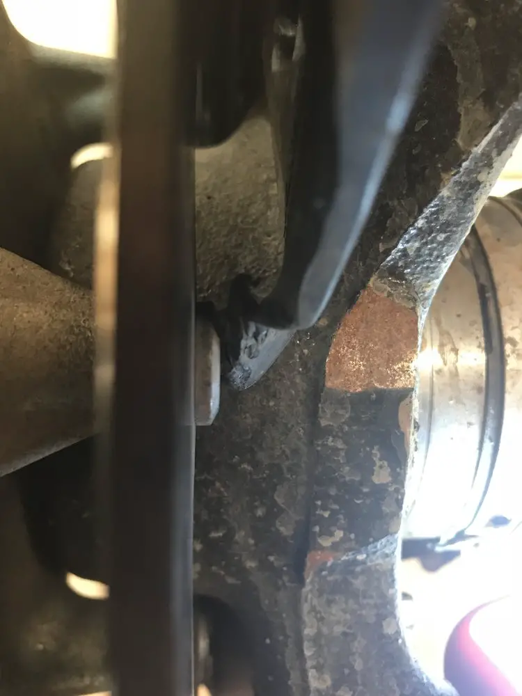

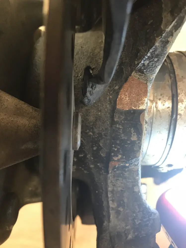

350 miles on my P1000-5D and at about 250 miles it suddenly developed a noise in the front drivers wheel. Kind of a clicking/chirping noise. The repetitions are of course closer together the faster I’m going, I can lean out and hear it over the engine noise. I can’t see anything on that side upon inspection that’s visibly damaged.
Any ideas guys??
Any ideas guys??
Brakes or bearings, pull the wheel, spin it, remove brake caliper and spin again. If caliper removed and noise is still there, either grease or replace the bearing.
If removing caliper has no noise, your problem is brakes.
Thanks dude, I’ll give that a go today!!

Pulled the wheel and found a very minor problem. The plastic guard at the top of the brake disc received a bang by a stick most likely and was bent over on the lower tip, so I just cut it off.
