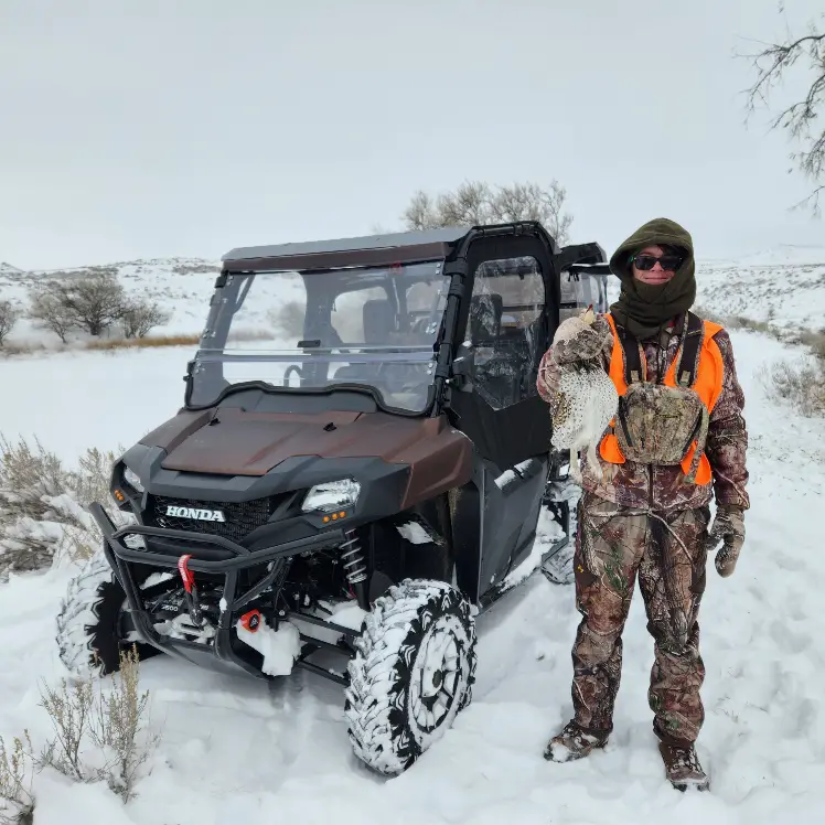

Das Moose is definitely paying off. Double load today in the Dirt Road Fabrication bed extension.
Went through some wild country. Definitely need some more clearance. Weather was better so we only had to dig out once. But with 2 extra critters in the back we squatted a bit more. Started hearing bumps below. Probably will eventually bump up to a better shocks too. The dang soft doors were driving me nuts as well with opening and closing but they're still better than nothing.

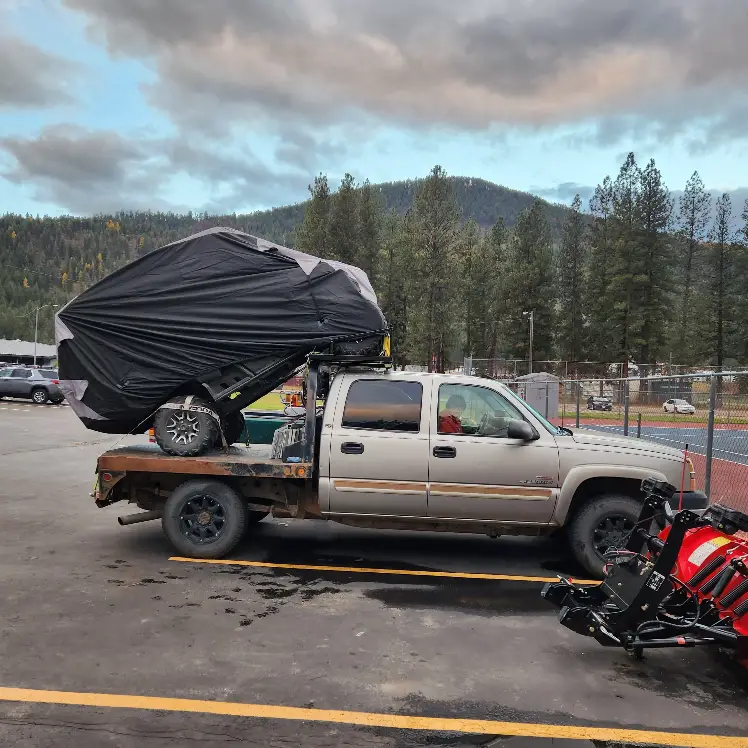

7) I built and installed my truck overhead rack to load Das Moose on my flatbed. It works great. It feels a little nerve wracking when loading and unloading but the trails here are more sketchy. Again, I want more low speed control, so I use the winch to help ease it up both ramps. With the wheel straps and heavy duty ring mounts in the flatbed the machine doesn't budge an inch. I stopped several times to check along the way to camp. I have no doubts I could roll the truck and the Honda would still be attached. The best part is my camper hitches right up with no clearance issues. On the highway, I was stable and steady the whole time even if being passed by tractor trailers. 10 hour drive here to hunting camp with no issues.

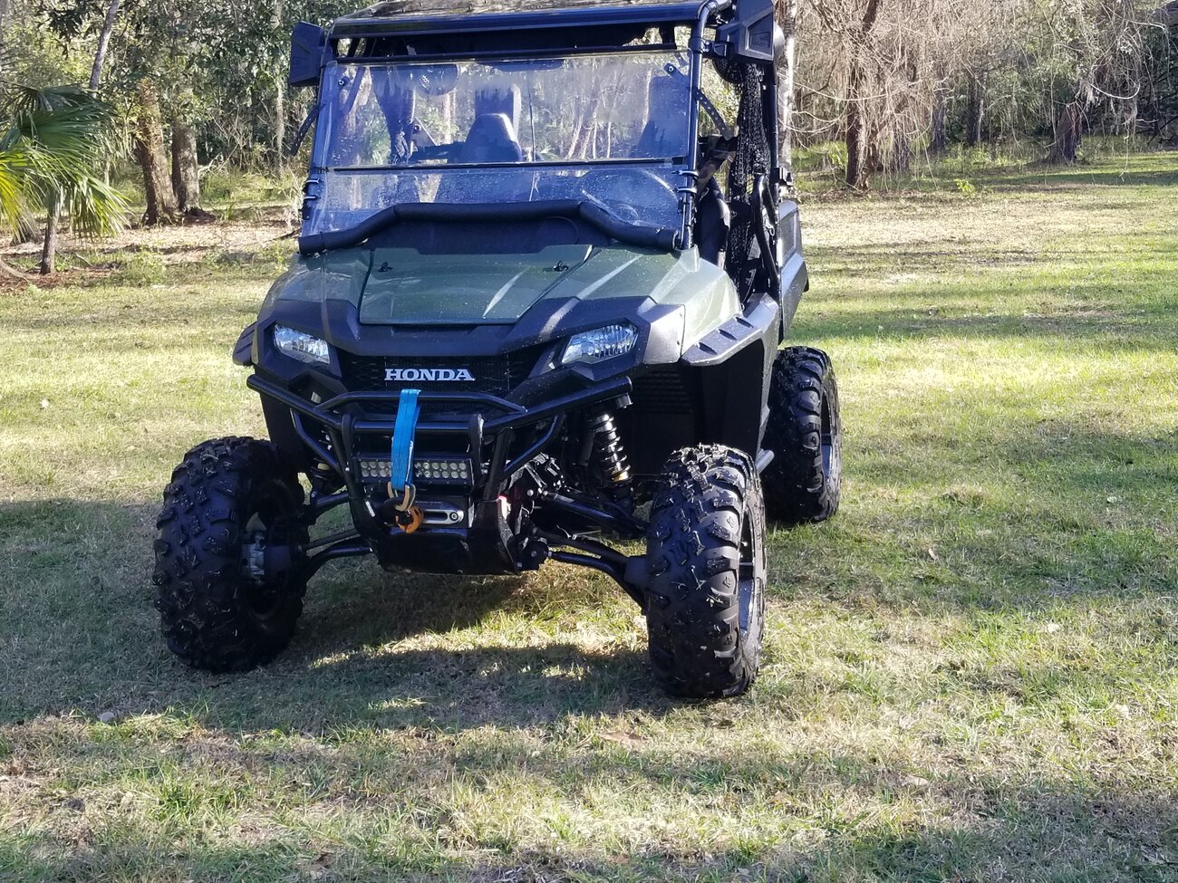

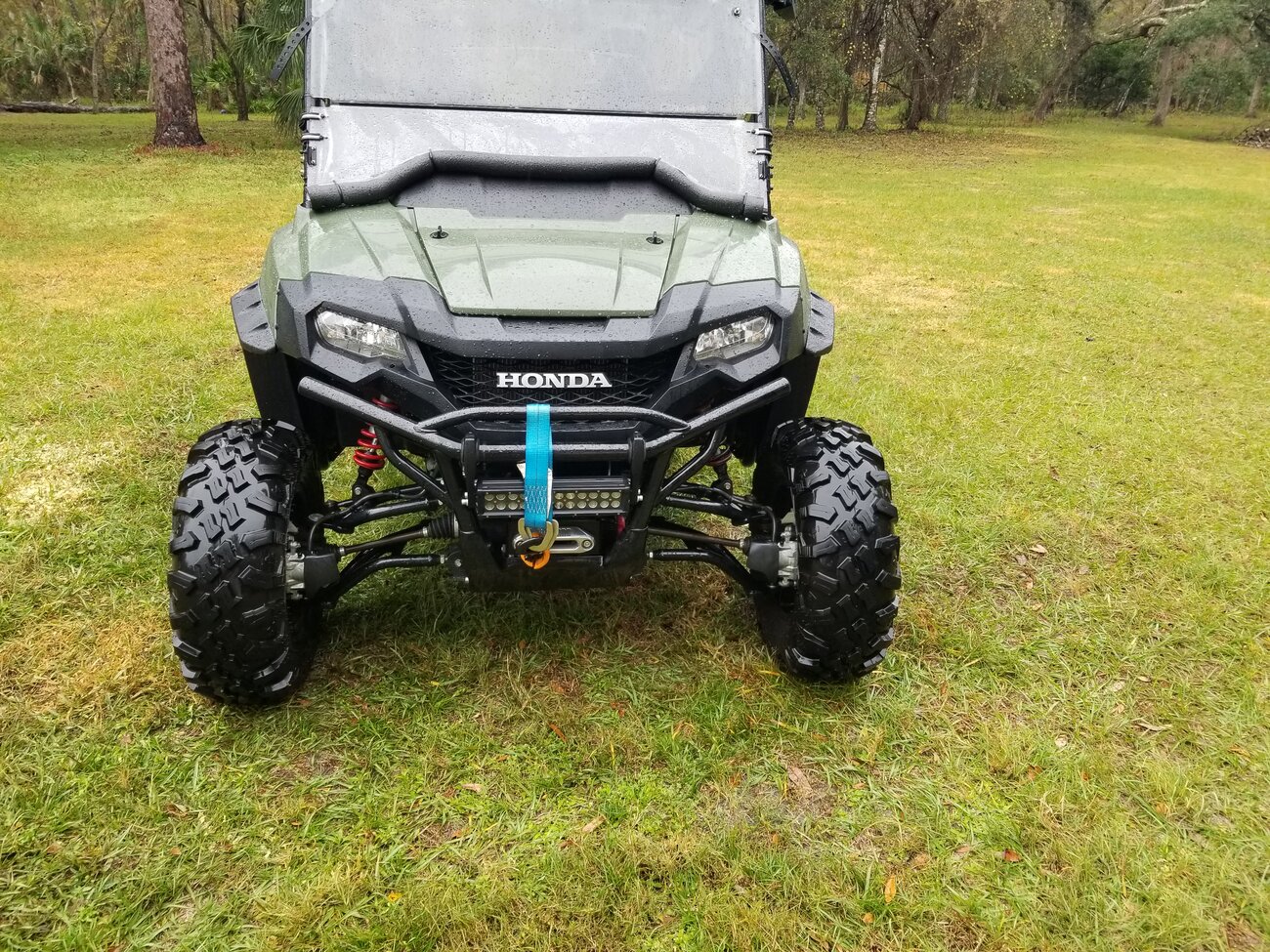

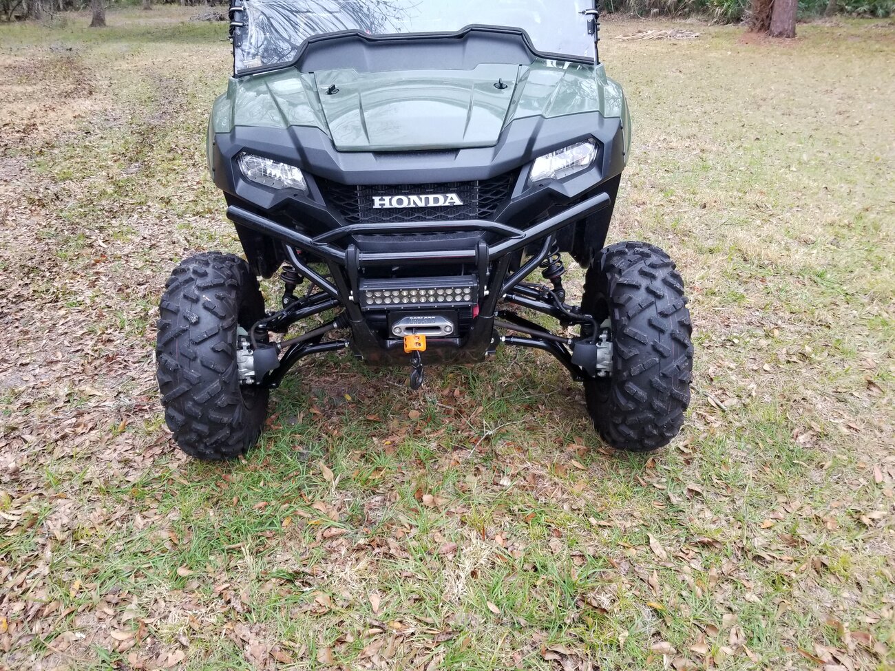

Foward arms are nice with 28 or better tires. I am running 28 with foward arms. I let a popular tuner use mine for beta testing and he came out with 4 different tunes. You will also need the programmer.. I will say mine has more bottom end with the 28's and quicker acceleration than it did with the stock 25's. The speedlimeter is disabled and the rpm was increased by I think 300. I have hit 49 on speedometer and bounced off 53 by Gps. It gets to forty faster and smoother while running cooler. My wife says it seems quieter also. I also am running a pair of bandit shocks I had them build for me that gave me more travel. I love these. These are just some things that I have done that I think improved most things about the 700

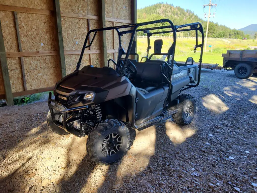

Alright, alright, alright! Finally went and picked up our 2022 700-4 Deluxe. We left Montana this morning at 9 am and finally got back at 7 pm. I don't think we spent more than 30 minutes at the dealer. It's been a trip but we got the rig we wanted. I even took a picture for @Remington so he knows it happened ;) On the way down the missus and the boys were joking about how we how planned on the "Das Moose" project name which has been a running joke for us going on a few years now. Coincidently we saw not one, but three, moose at different spots along the drive. Both coming and going. The name is now official I guess.
So starting tomorrow we start adding parts and the build begins.View attachment 340789

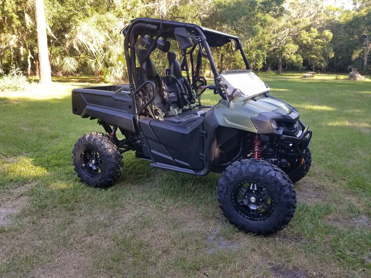

The seat backs are from a polaris razor. Any year will work. No need to mod the pioneer. Just need a piece of steel mounted to back of seats using factory holes. Bolt that to the factory mounts on pioneer. Harnesses are 4 piont of Amazon. Tunes come from FCP. He has 4 and right now I am using Stage 2

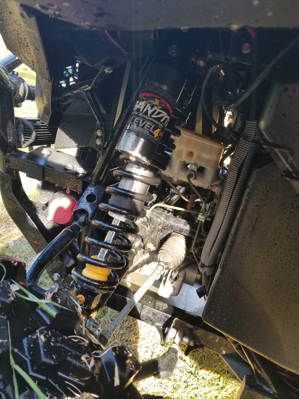

@osobad So you are running the forward A-arms with no portals correct? Are you running a new exhaust or air filter with the tuner? I will look into the Bandit shocks. I wonder if anyone has ever tried air assist bags for heavy loads like on pickup trucks?

No portals. I do have a uni filter with snorkle using 2 inch vac hose routed to roof side. Exhaust was stock. Opened it up a little after mods were already done by removing cat but not necessary
