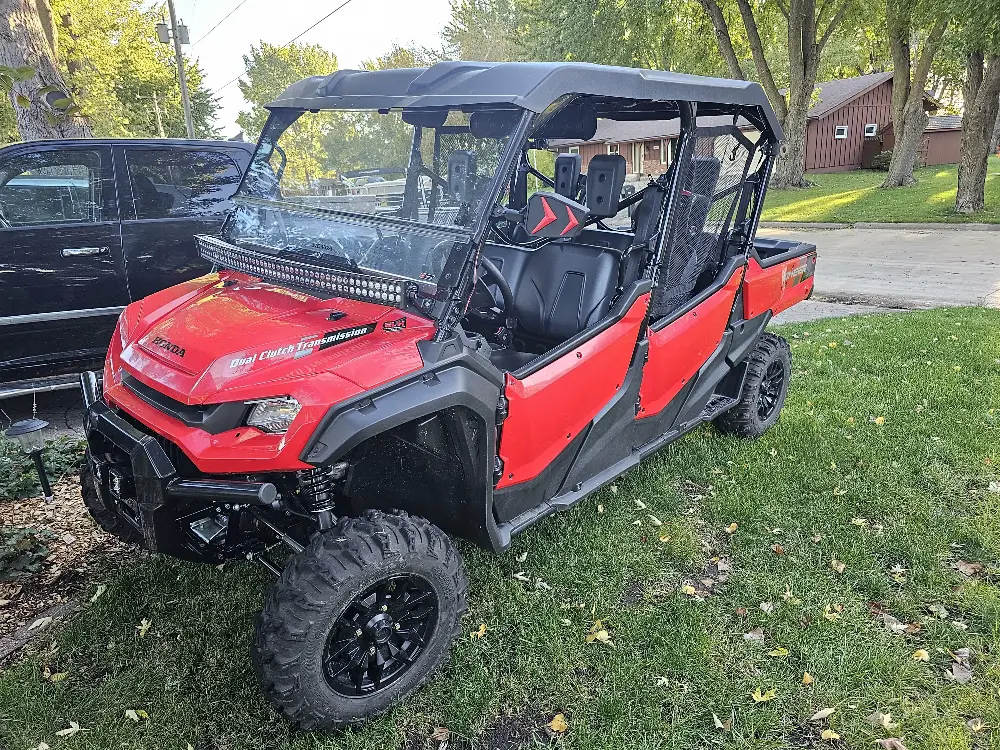

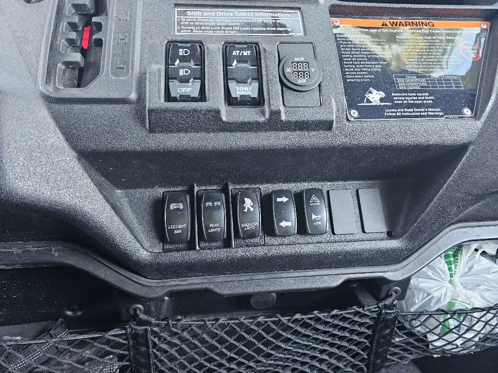

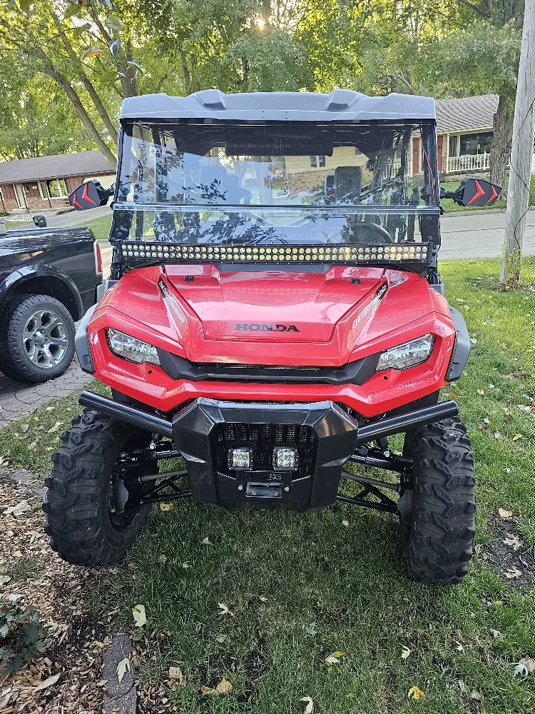

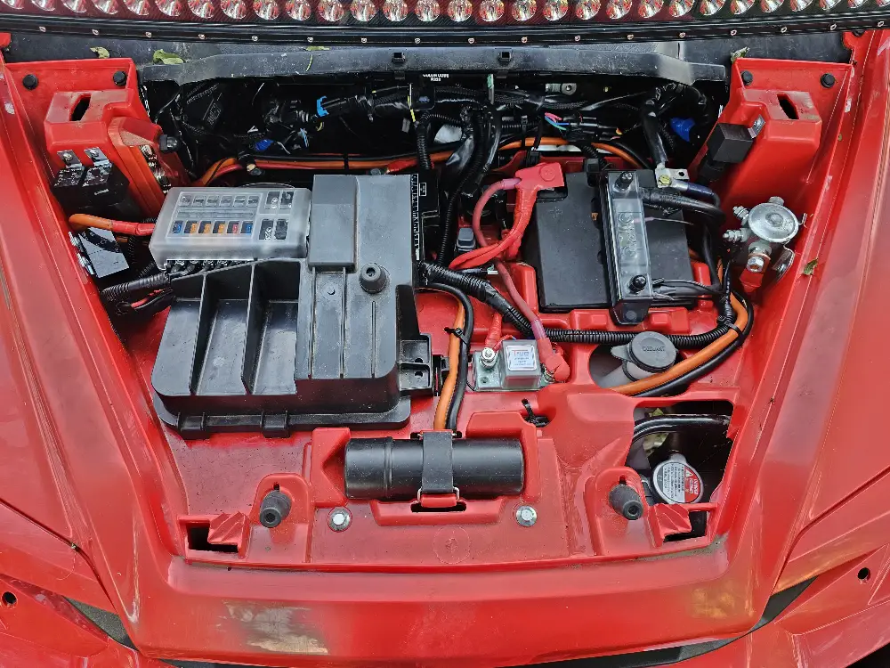

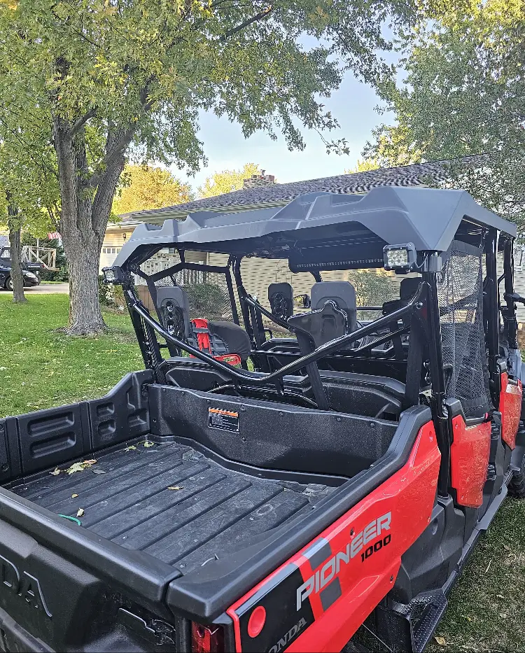

Hey, all, just thought I'd say hi and show my rig. I've spent the last couple months lurking and the dual battery threads were a tremendous help designing my system. Got into it and decided it was over my head, and so had a buddy who is a mechanic and loves customizing things finish it out the dual system for me. I gotta brag on him a bit, he did one of the cleaner installs I've seen. Did it in a quarter of the time it would have taken me.
Only thing a little unique on mine is I also installed two Black Oak infrared pods so I can run night vision easier chasing hogs or yotes.
Missing a winch right now and still figuring out a rear window and something for upper doors.
Build list:
Black Oak Infrared pods
Nilight ZH120 50 inch LED bar
Night flood pods on the rear
ECOXGEAR sound bad
Honda SXS shop sequential turn signal kit
TRU UTV dual battery kit with Cole hersee and SOYOND fuse box
Kemimoto mirrors
Stock roof and windshield
Not done tinkering, but it's a good start. 0ec8a64bd9e8e85efc1587c4a232e9fb00eb2190d290d9bf5a00889e4c76766f2120c9b2cc72d1275362c1c1f9f664a51bbfe78ffd807ca79d3f7654e3520f6419e64df9e367d1183505339b12998bd2

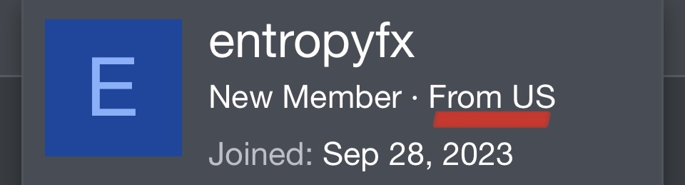

Not sure where "From US" you live, but if it freezes where you're at, replace that Cole Hersee with the marine rated one. Otherwise, moisture can freeze it up.
Build list:
ECOXGEAR sound bad
Kemimoto mirrors
Not done tinkering, but it's a good start. View attachment 406957View attachment 406958View attachment 406959View attachment 406960View attachment 406961

Oh no, seriously? Iowa boy here.
Yup! Better fix that!

Thanks for the catch. I'll order one to swap out.
I wouldn't make it priority #1, but keep it in mind for sure.
You used to be able to buy them all day long on Amazon for like $35. I haven't seen one in stock on the marketplace for some time now. The last one I bought was from O'Reilly Auto Parts (online), but they don't have any ATM. There appear to be a few available around the web for about ~$45 - you'll likely find them at marine stores or online marine parts retailers.
If you see a red one, those are produced in Mexico (now). They have one rated at 65A (24117) and one at 85A (24117-01).
Whichever one you purchase, make sure it is rated for continuous duty, not intermittent duty.

Got it ordered for $50. Can I wait til the other one dies or would you just replace it straight up?
That depends upon whether you want to replace it when it's 45F (now) or -10F (later) ... :)
I actually have a spare (marine rated) in the parts bin right now.

Any chance you can share the link to your rear pod lights? Or post a few close up pictures of the rear mounted lights?
I got a pair of pods from Harbor Freight and am trying to figure out how to mount them back there on my 1000-6. Seeing the bracket you used would be helpful. [mention]entropyfx [/mention]
