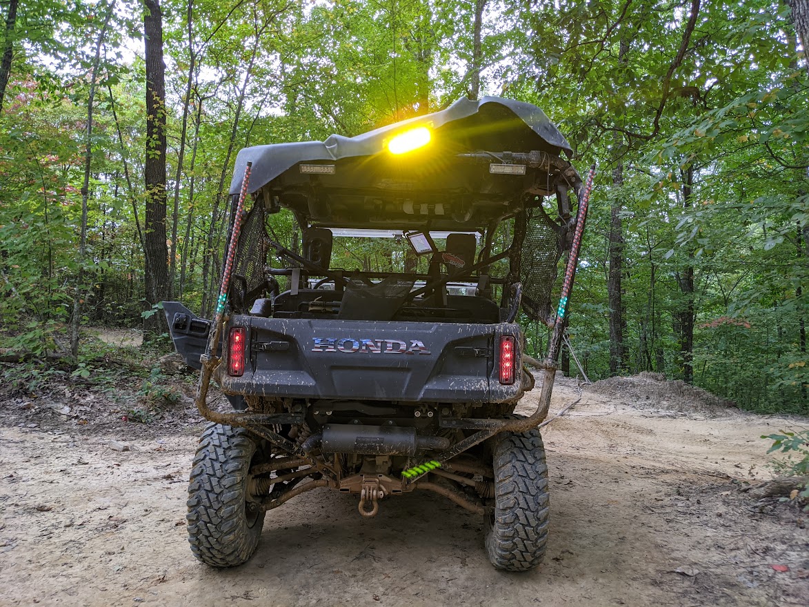

New tires,wheels and 1” spacers on the rear. installed! Rides great!
