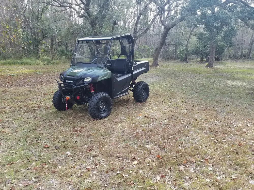

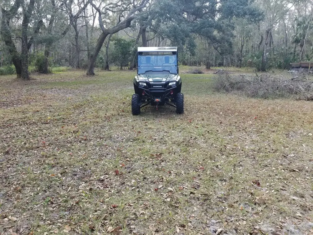

1inch spacer with same size tires with same result
