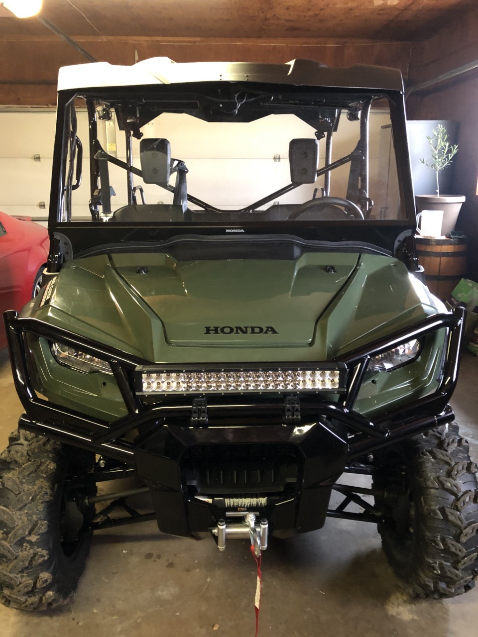

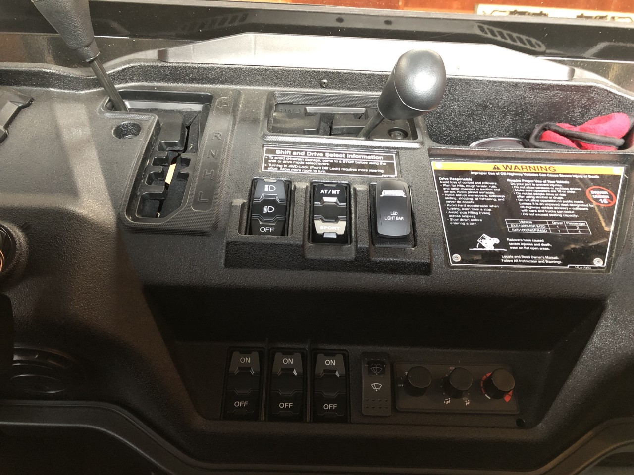

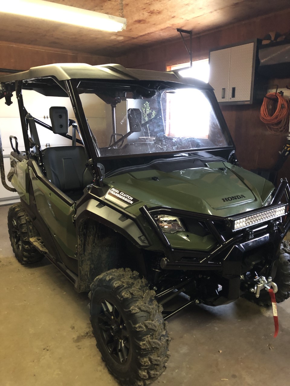

Here's the completed job. In addition to the heater, these accessories/mods were also installed while it was apart:
Honda Wiper w/reservoir
Honda Fuse box w/bracket and wiring kit
Honda rearview mirror
Honda Upgraded front bumper
Honda Winch and bracket
Dual battery kit w/Odyssey second battery
Dual battery voltmeter
HondaSxS switch adapter
Dome light (tied to factory switch 1)
Front LED bar w/relay (new switch w/adapter from HondaSxS)
Side LEDs w/relay (tied to factory switch 2)
The heater works well and puts a lot of hot air out when moving. It's a little noisy but not too bad.
