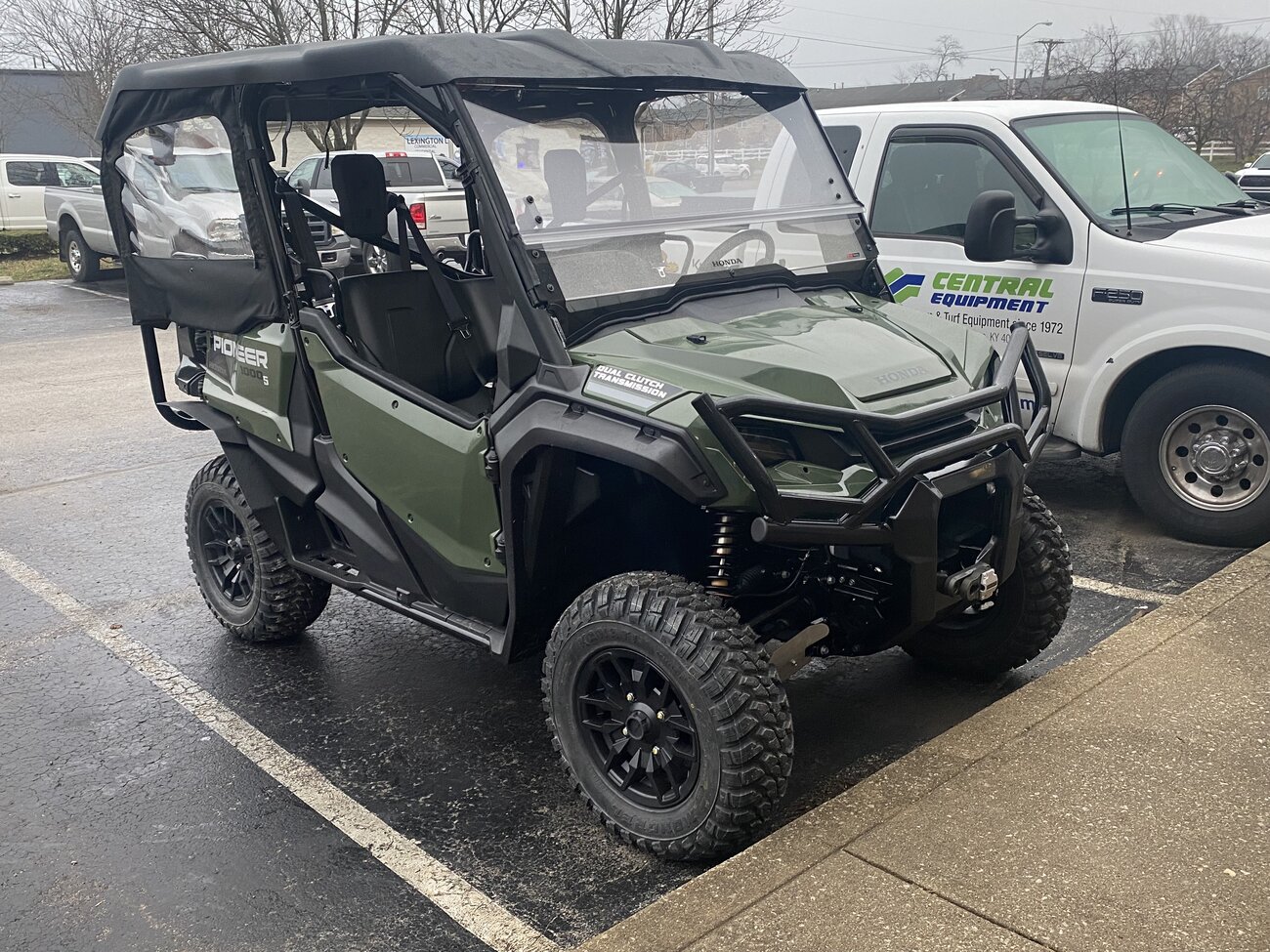

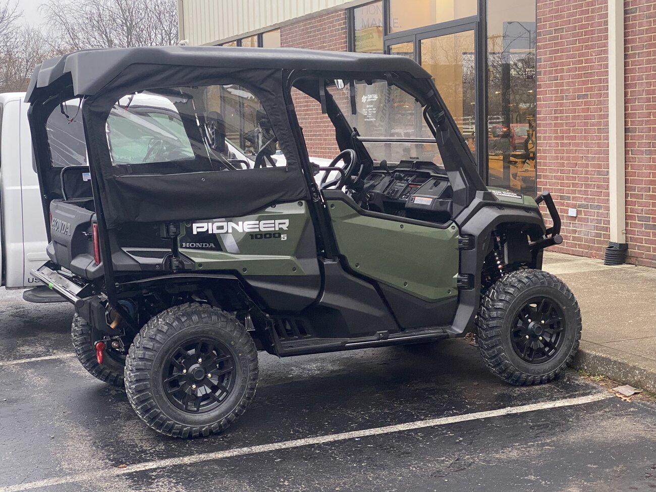

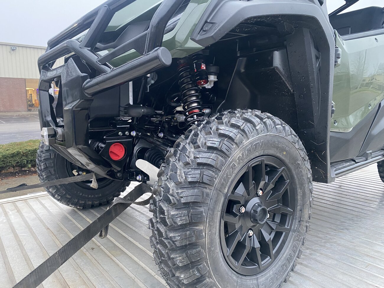

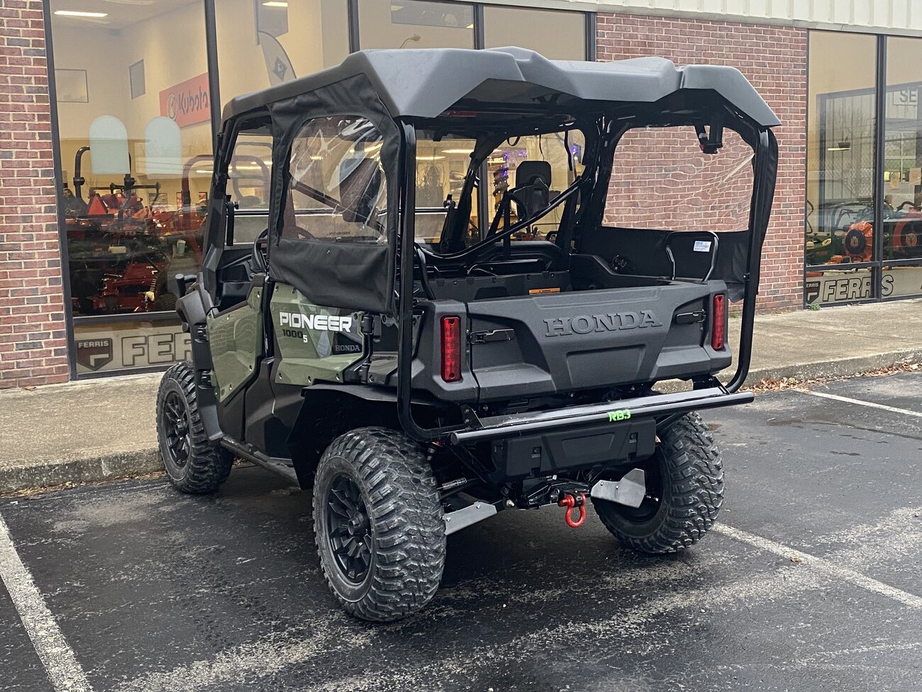

I'm running 28-9-14 and 28-10-14 Mongrels on mine
IMG 3010 IMG 3008 IMG 3006 IMG 3011

Really like them. I've ran them on my Kubotas for years and we sell a ton of them at the store. 10 ply radials. I've never punctured one and have customers that go through a set a year with great results.

I'm running Elka Stage 5 suspension and only drove it sparingly before installing the suspension. I have mongrels on several Kubota Sidekicks that I own and feel they're much more stable at speed, clean themselves really well and have an abundance of traction over the stock tires that come on the Kubotas. The stock tire that comes on the Kubota is 6 ply and I'm sure stability comes from increased sidewall strength. The tires that were on my pioneer were removed shortly after purchase and I've been mostly running the Pioneer on the road. It corners well, and I can get the rear to step out (confident drift) in turf mode with a little throttle input on damp roads. I'm very pleased and it rides very nice. I do have a slight vibration above 60 and probably need to have them balanced. I always run sealant (not slime) in my tires when installing on alloys, so running tire beads is a no go
