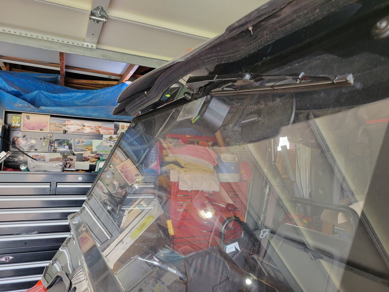

I wanted to ride on the Oregon coast but one of the requirements is you must have a windshield wiper if you have a windshield. I have the polycarbonate split window and the Honda wiper kit will not fit but they don't say exactly why. I bought it anyway. Turns out the wiper arm is 3/4" too long resulting in the wiper blade hitting the raised portion of the window mid stroke. To make it work I cut out 3/4" of the wiper ar
Wiper
m welded it back together, sanded, and painted it. Looks factory and works like a charm.
Regards,
Kevin
Reactions: Farmer

Hi Kevin, I just ran into a problem with my glass windshield, it seems to be susceptible to stress cracks....at $350cad per windshield replacement, it gets costly to replace. I wanted to go with a Polycarbonate windshield like yours but I was told the wiper causes scratching on the poly. Was this the case with your machine. Thanks
Yes. I have to polish it regularly.
