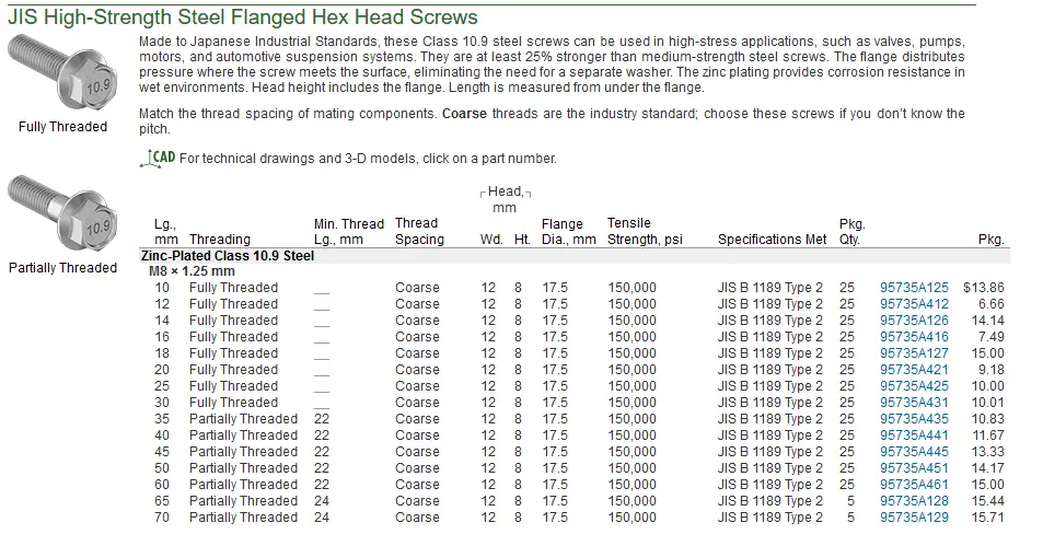

The bolts are special.
They do not meet the JIS standard for flange head cap screws.
I want to say it is a 10mm head on M8 thread.
The JIS standard calls out a 12mm head on M8 thread.
I have an assortment of the below in stock. They are what I used when mine stripped the heads.
1698693328836
This was wildly helpful. Thank you. I picked up some new ones, and as you said they're no longer 10mm but 12mm.
Thank you!!!!
interesting. can you advise which one you chose? fully/partial threaded? length?
Neohio
Neohio
Beast of the East
Dec 22, 2016
13,409
65,692
Painesville Ohio
I don't honestly remember which bolt I used. I bought a package of each size. The hinge is thin, so you need a fully threaded bolt. Chances are I used the same length as the Honda bolt.
