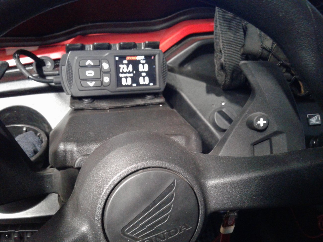

Using <> DynoJet-Power Vision "seen in Picture below" <> ( setting provided at purchase ) Picture included to prove it exist
Engine Temperature in Actual Fahrenheit Degrees° & RPM <> along with several other features.
Key on reading is <> Air Temp ( of your surounding area )
Cold Engine start <> Progresses Rather Quickly up to 150°/ 160° <><> Slowly Rises to 195°/196 ( After several Stat Open & Close Cycles )
At 195/°196° ××× STAT OPENS ×××"" ONLY For a FEW SECONDS"" ××× Quickly Drops to 185°/ 186° </> STAT CLOSES
THIS PROCESS REPEATS Several Times ( at idle ) 25/ 30 minutes ×× little quicker at 4000/ 4500RPM ×× Eventually ×× Whloe System Reaches 195°/196°
Depending on Atmosphere Temp </> Length of Time Will Vary
Engine Temp ×× CONTINUES to RISE to 2017°/2018° ×× Until Fan Comes On ×× Fan turns off at 195°/196°

What that display you have that’s nice setup
