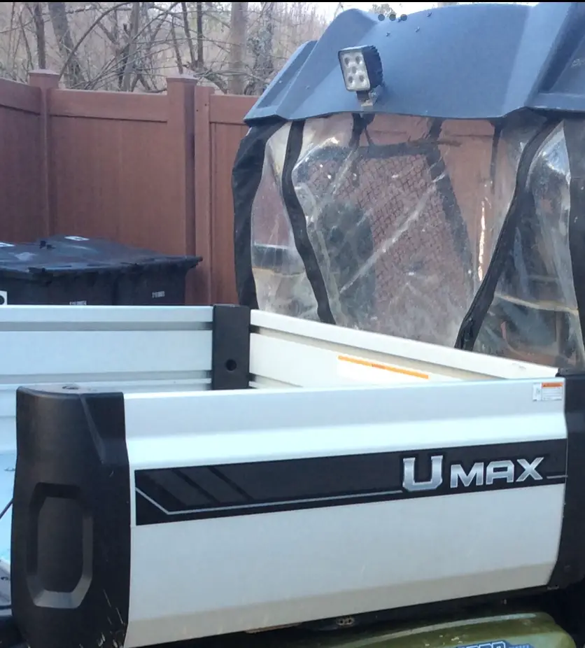

I have the Honda soft rear window on my p520. When I plowed snow with my 520 for the first time a few nights ago, I found it very difficult to see out the back thru the window when I was backing up. It was dark and snowing hard at the time. I might need to install a small rear-facing flood light. ...just something to think about when considering rear windows.

One option is a LED light on the lower center rear of the OEM roof for a cab dome/cargo bed/back up light. Kept the bracket just snug enough to be able to tilt it towards the cab or rear facing. Dash switch wiring is connected near the light using the 2 lead plug to make it easy if removal of the roof is ever needed.

One option is a LED light on the lower center rear of the OEM roof for a cargo bed/back up light. Kept the bracket just snug enough to be able to tilt it towards the cab or rear facing. Dash switch wiring is connected near the light using the 2 lead plug to make it easy if removal of the roof is ever needed.
View attachment 312971 View attachment 312972
Thanks....that's likely where I'm headed.

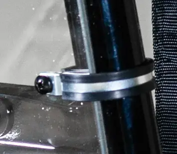

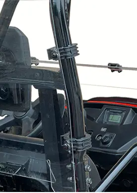

I think the clamps are going to be my issue with the doors:
Untitled1
Anybody know where I can find these? I think the 500/520 ROPs are 1 5/8" but I cant find them on Amazon or anywhere.
Untitled
I should have spent the extra cash and got this one I'm thinking....
I feel like if I can find those clamps that utvwindshields uses it should hopefully be able to work.
Looks like something an electrical supply place would have lots of in various sizes

My emp windshield uses them and they work well. Probably less obstructive than the others.
I ended up just paying for them - was like $46-47 after I got the 10% off. Annoying as s***, but prob will lead to less hassle.
