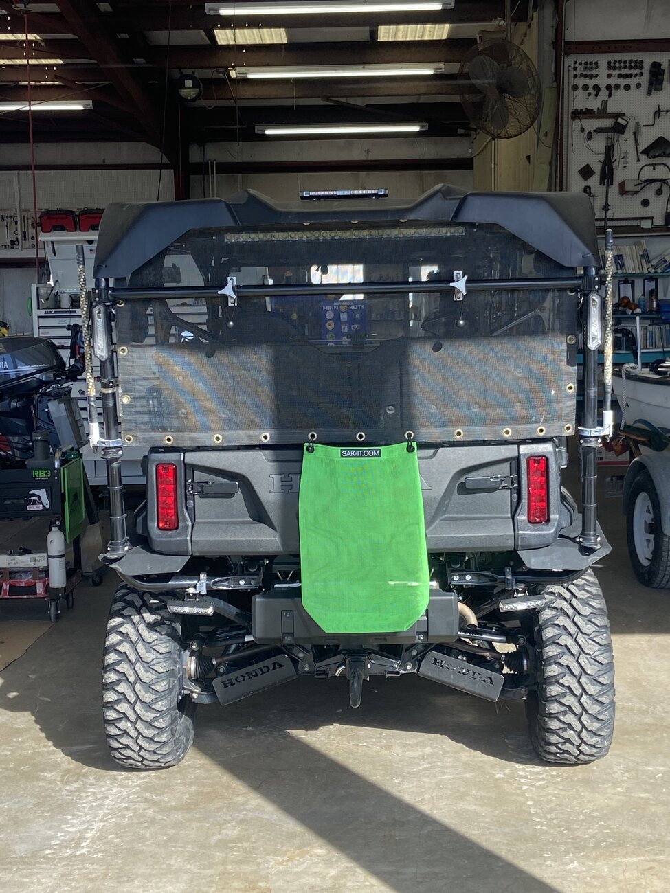

I wound up adding more preload to the rear shocks, so now as it sits; the front preload is at 1-1/2” and the rear’s are at 1-3/4”.

My skid plate ground clearance is roughly 12-1/2 to 13 inches. My rear buggy height is now 78-7/8” which is ok, because the pull down screen in my ToyHauler measures 79” from the floor.

As the shocks break in and settle, I might add more preload to 2” of thread showing.

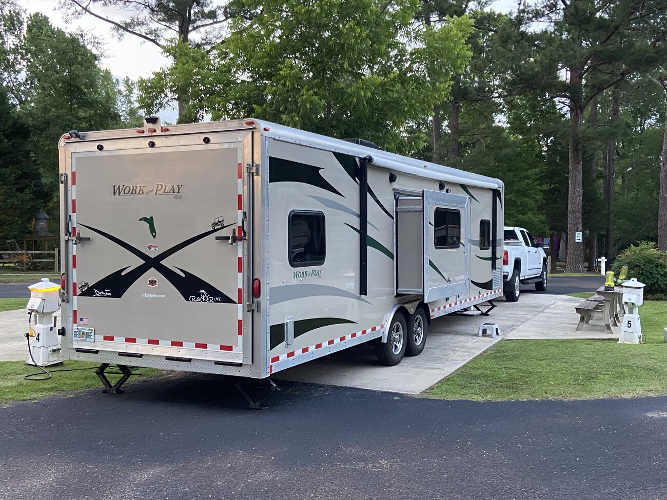

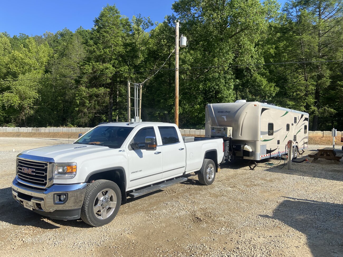

What kind of Toy hauler is that, looks good 👍
FL_CrackerLife
FL_CrackerLife
Feb 24, 2017
188
843
Lecanto, FL

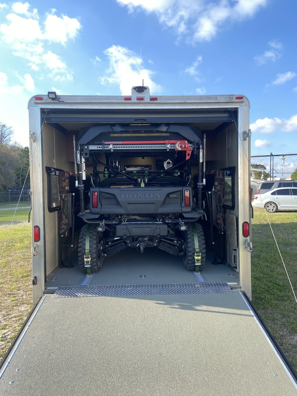

Thank you, it’s an older 2013 Work and Play wpt30wrs. It’s a tight fit with the Pioneer, but it does the job! It met all of “The Requirements” from the FL_CrackerWife. Haha, and it was in our budget [that was the main reason we got it]
IMG 7174
IMG 7269
IMG 6209
IMG 6206
IMG 6203

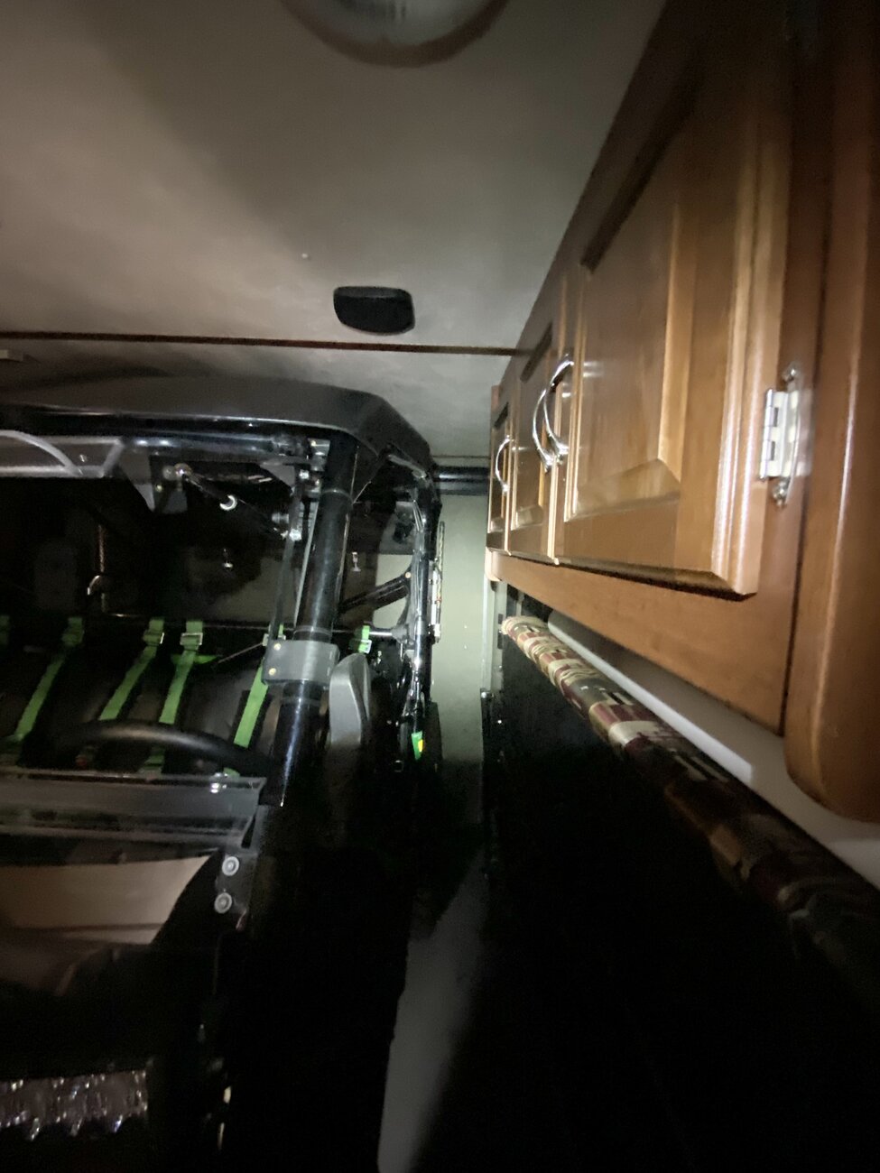

I would’ve loved a longer garage, but we make this one work. (For now) I’m worried if I add arched a-arms that extend the wheelbase 3” I may not fit it on the garage.
But ol stocky is doing just fine…… For now! lol.

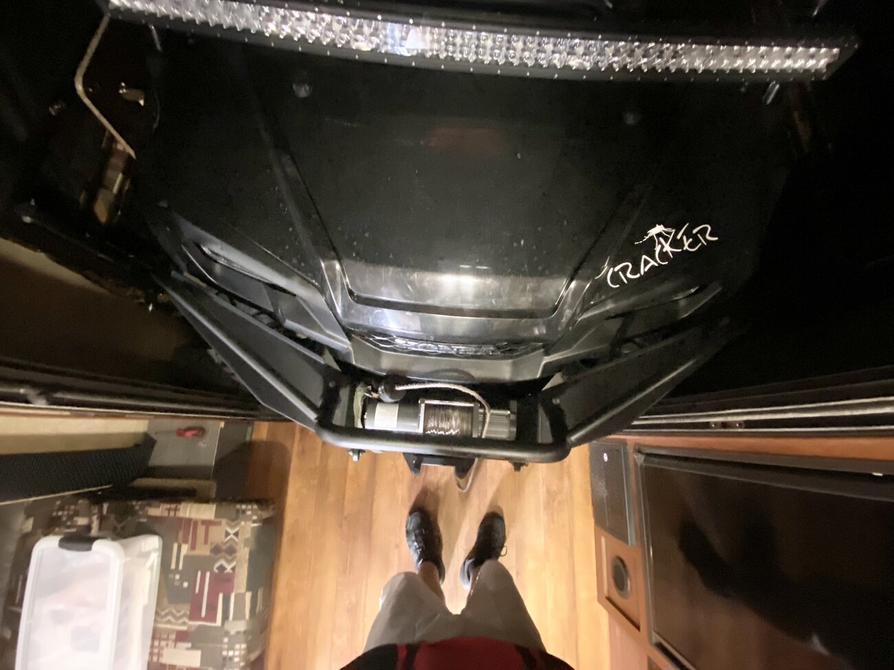

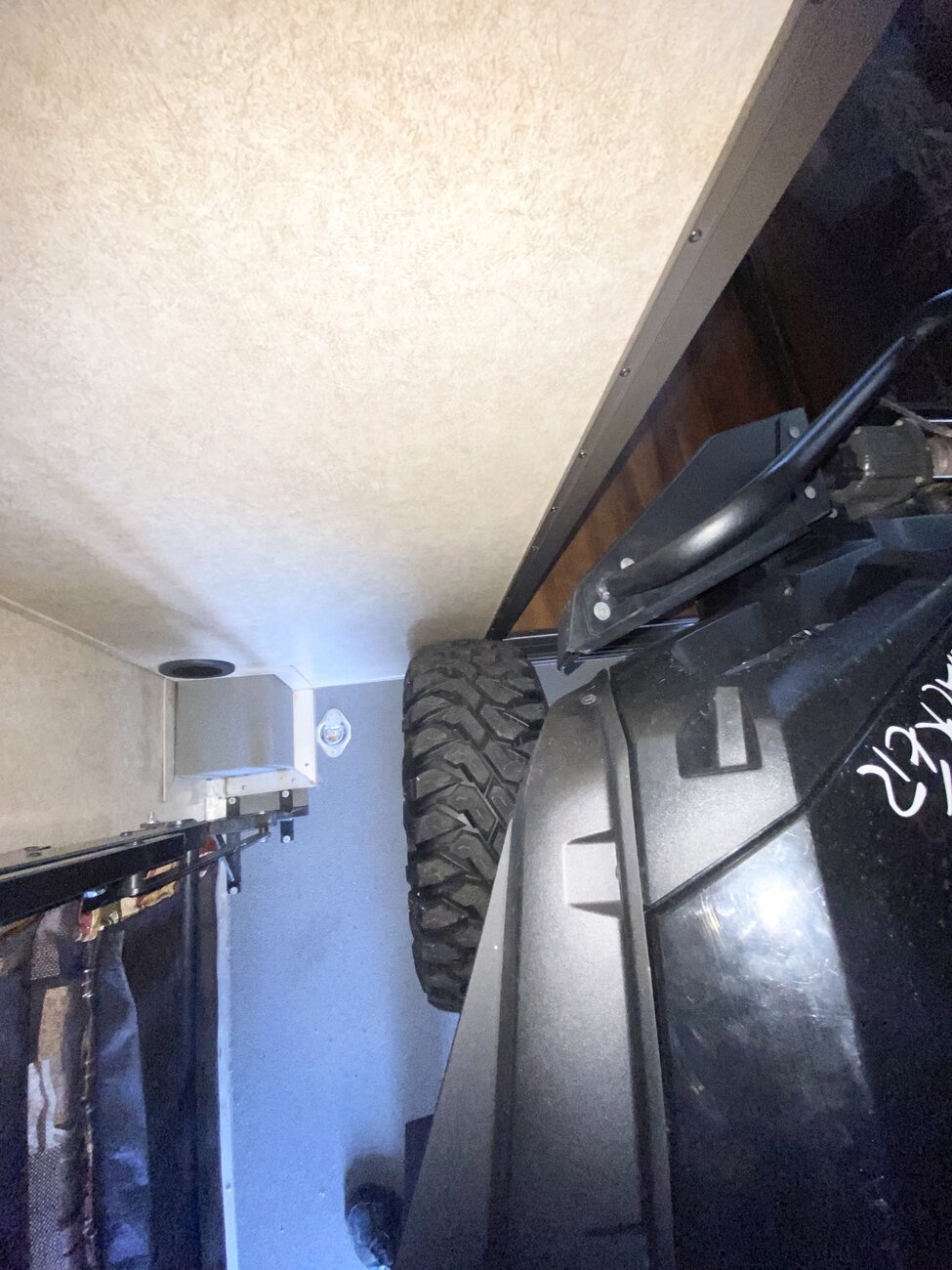

Thank you, it’s been a work in progress. There is about 2 inches from the back of the buggy to the ramp door when it’s closed.
We might look into having to top lowered, how well do y’all fit in there with the chopped tops? The reason I ask, is I’m 6’3” and my wife is 6’.

6'3" I can't speak for, cause I'm only 5'7" sooooo 🤷‍♂️😂 but I know some of these guys that have chopped tops are 6'+/- and no issues. You can chop as much/little as you need, I did 4, 4.5, and 5 front to back. This is my 6'2" brother-in-law driving, plenty of head room in my opinion

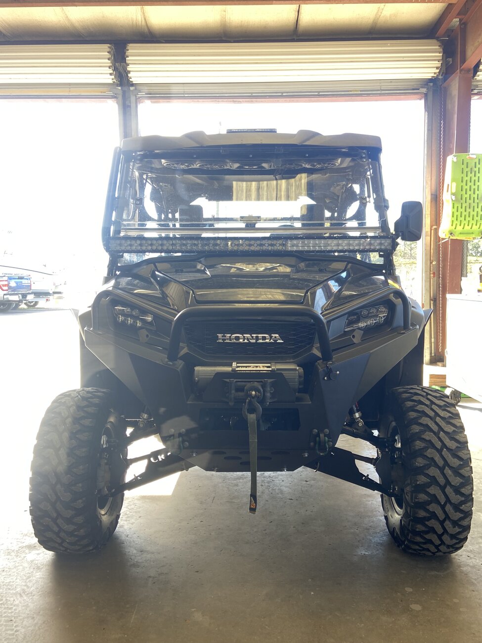

Ok y’all, I just got back from my New Year’s ride with @Tramguage1 and @knuckledeep.
We covered 140 miles in 4 days, in the Ocala National Forest, and the M1 shocks did not disappoint! I wound up tightening the rear preload to 3” of thread showing under the upper spanner nut. I wound up using every bit of shock available! While it still rides like a pioneer, we were able to ride more comfortably without the bracket lift and the shocks soaked up the washboard bumps (I was able to run at a speed of 22-25), however I had to slow waaaaay down when it came to the whoops (14-15mph). I’ll be keeping the M1 shocks.
