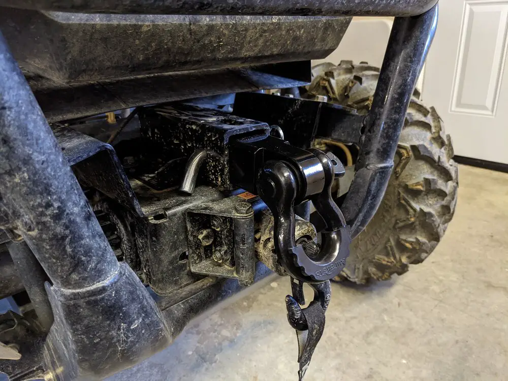

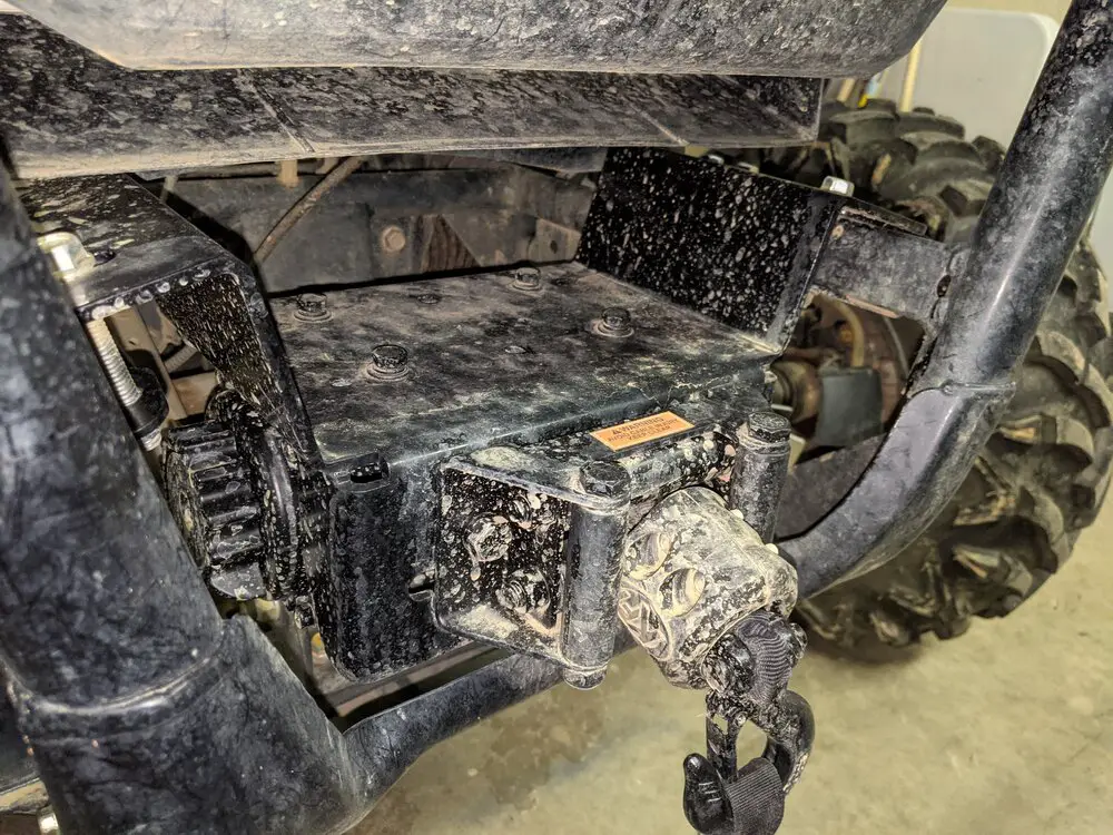

I put on a shackle in the front hitch receiver. Works ok, but looks meh. I'm leaving it be for now; we'll see if it grows on me.

I just mounted my winch today with that 2” receiver on top. My winch hook fits in the slot in the top face of the 2” receiver so that is an option for a double pull with a snatch block.
