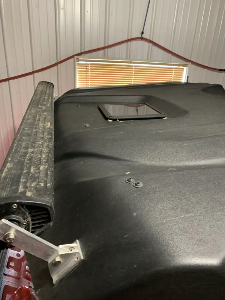

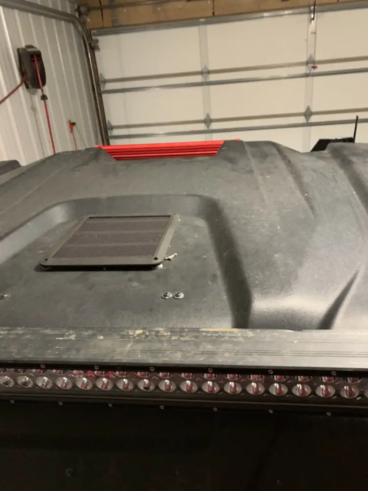

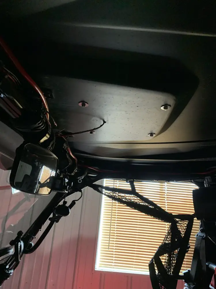

Hey guy I know this is an old thread but I didn’t like that it seemed I needed to put my Honda on a trickle charge after every use. So I did just this I mounted a small solar panel on the roof and it works great now I have gone months without have to plug her in. And with how it’s mounted haven’t had any problems with low hanging branches it seems to charge while in the shop under my led shop light as well. Let me know what you think

View attachment 161524 View attachment 161525 View attachment 161526 View attachment 161527 Hey guy I know this is an old thread but I didn’t like that it seemed I needed to put my Honda on a trickle charge after every use. So I did just this I mounted a small solar panel on the roof and it works great now I have gone months without have to plug her in. And with how it’s mounted haven’t had any problems with low hanging branches it seems to charge while in the shop under my led shop light as well. Let me know what you think
Nice!!!
Reactions: Redone
