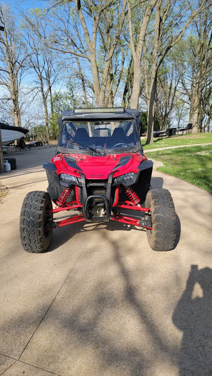

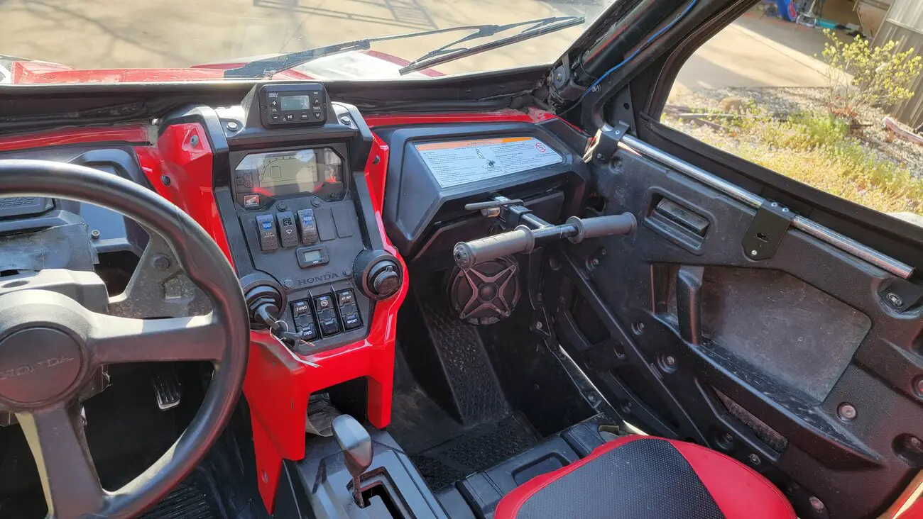

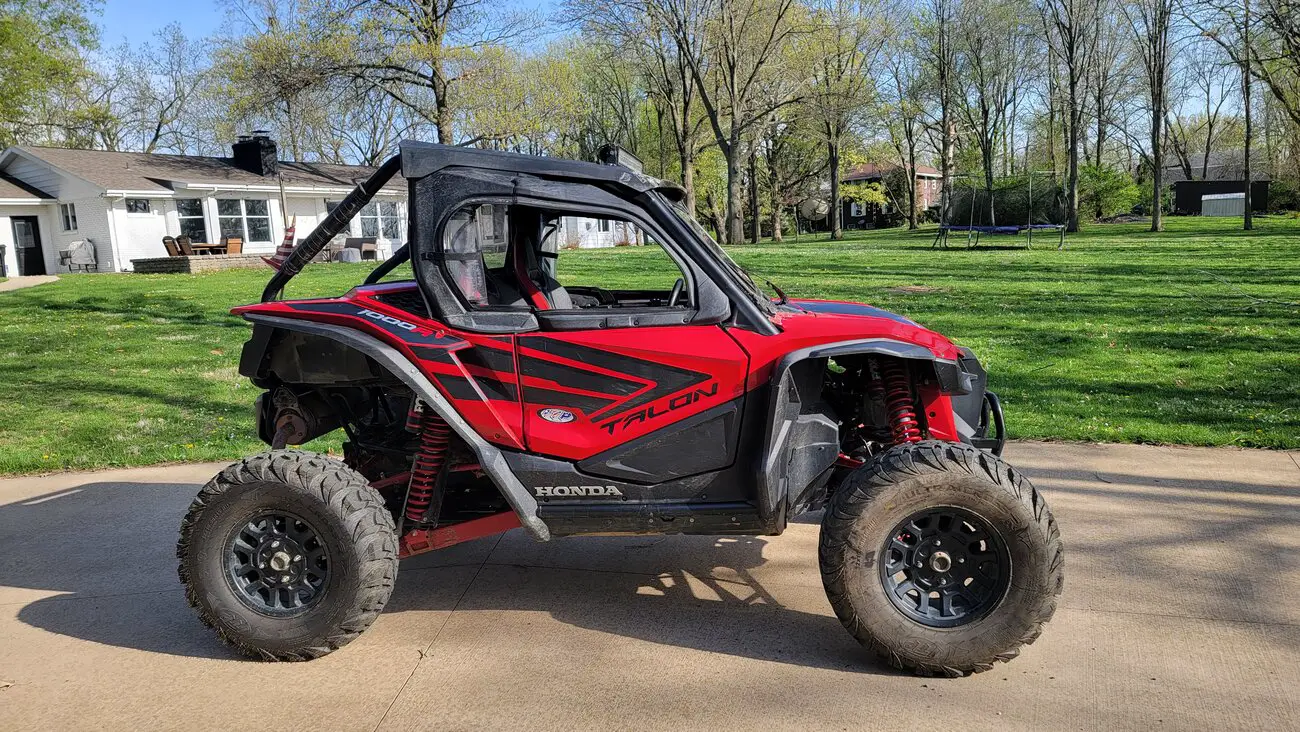

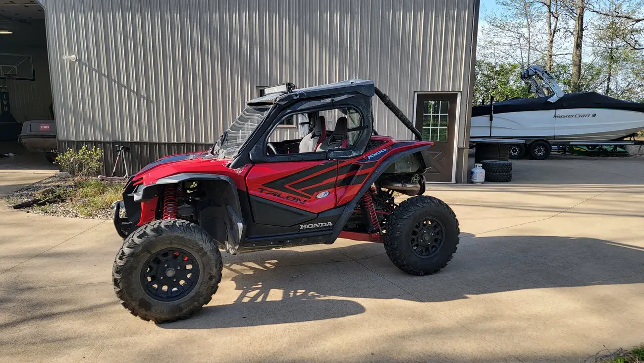

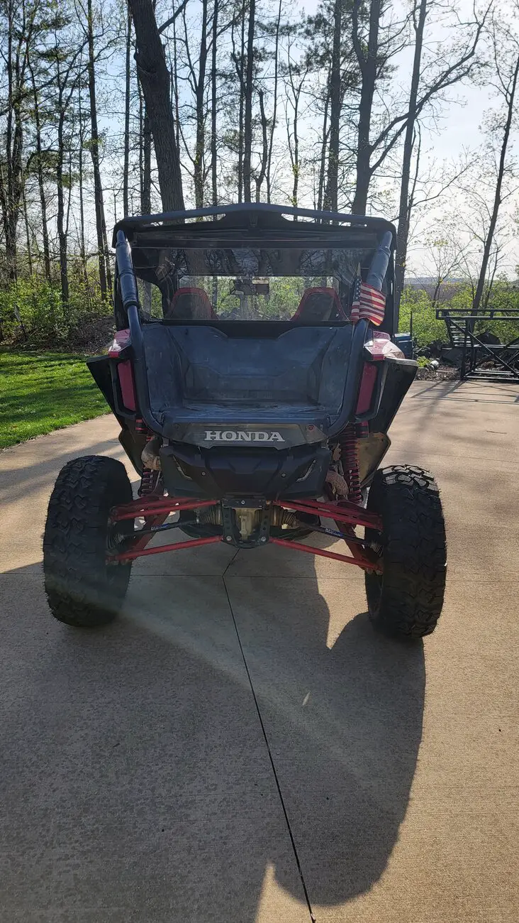

I picked this beauty up off a guy I know in Tennessee. He bought it new and has put all the miles on it. Most have been road miles but he did trial ride too. It is a 2019 Honda Talon R with 35,106 miles, the ssv radio, windshield with powered wiper, turn signals, rear window, upper enclosure, 32 ITP, light bar, etc. I paid 10k for it. The only thing he has replaced is the rear 2 axels for clicking. Everything else is original. I plan to do the usual things to it right away. This is our 4th Talon. This one is for our 15yo (or anyone else that comes) to drive. Here is the start of my list:
-Factory UTV 1/2 skid (I like this skid for its full coverage up high on the front and rear)
-CA Tech rear radius rods
-CA Tech shift gate
-new prop shaft (I have one with welded caps already sitting in the shed as a spare)
-Simpson harnesses
-lower aarms (undecided on brand)
-beadlocks and 32 or bigger tires
-probably a winch
-Full Cage (undecided which brand but I need 3)
-front ball joints (undecided which brand)
There is a little tick that I can hear start to sound after it has warmed up a little. If it ends up being a problem then I will rebuild it.

View attachment 383917View attachment 383918View attachment 383919View attachment 383920View attachment 383921View attachment 383922
