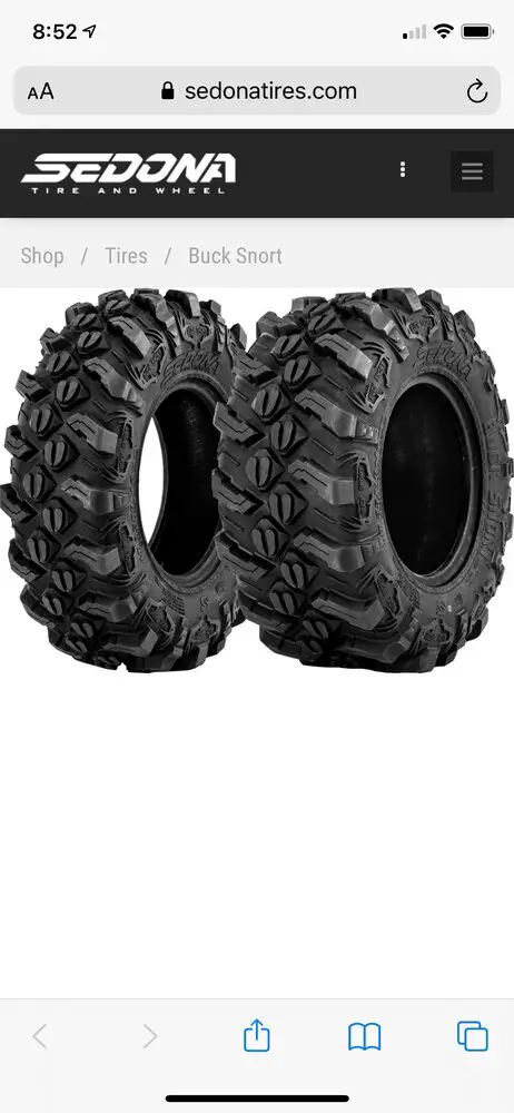

Does anyone know of a Sedona Buck Snort Tire size 27/11/12 will fit on a 2016 P700-4? Thanks!

It should I run 27x10 x12 all around. No lift no rubbing even at full compression

Thanks! Is the 10” close to rubbing or plenty of room? These tires at 27” only make 9” or 11” width.
Plenty of room. There are a couple of guys on here with 27x11x12 on all four corners . They never speak of a problem and they have pics
