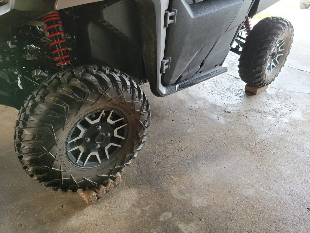

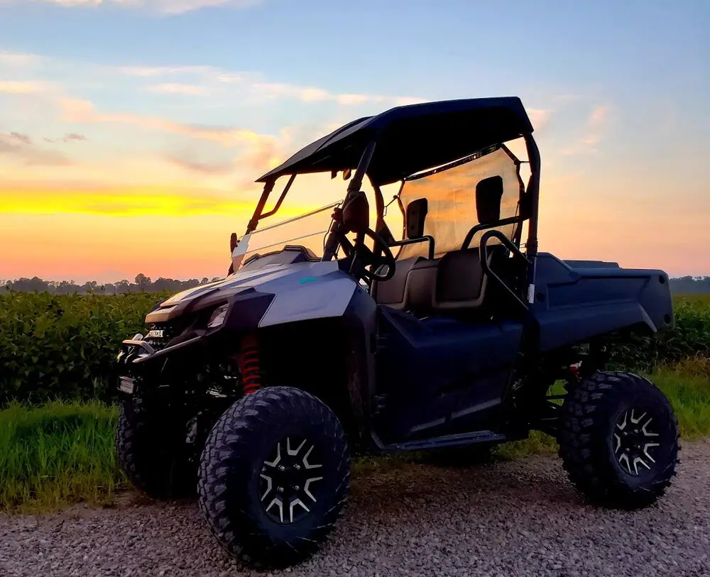

27's on the stock 12" wheels work great. I went with 27x9 front and 27x11 back. Love the stance and the gained height. Also have 2" spring spacers ready to add more height, but dont think itll make it in the garage if I do that.
Here is it on the road :cool: and kicked up a notch getting an oil change 😂
