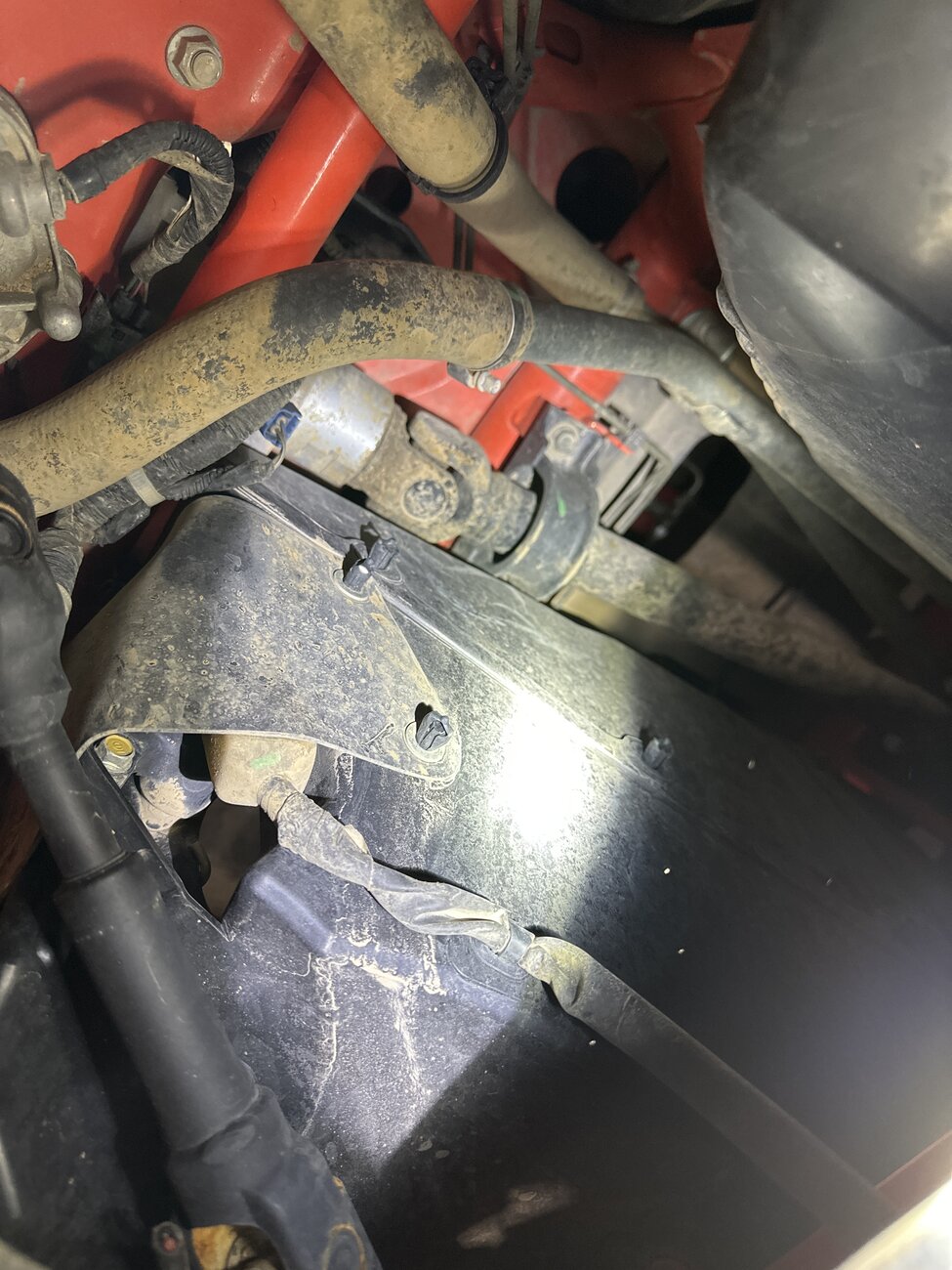

Been reading about some of the unjoints spitting the caps…it’s not clear to me if it’s a ‘19 thing or later? Should I burn a couple tacks on the cups? ( really surprised there’s not clips!)

Yah, it's a good idea to tack the caps. @SuperATV is supposed to be working on a CV shaft for the 4 seaters. I put one in my X2.....AMAZING DIFFERENCE

I did my 21 x4 when it had 1,500 miles on it. Upon inspection then all caps were still tight. Don't forget to disconnect your battery terminals and I also disconnected the connection to the CPU.

Remember to move your ground when tacking the caps so you don't run welding current through the U-joint bearings. :oops:
