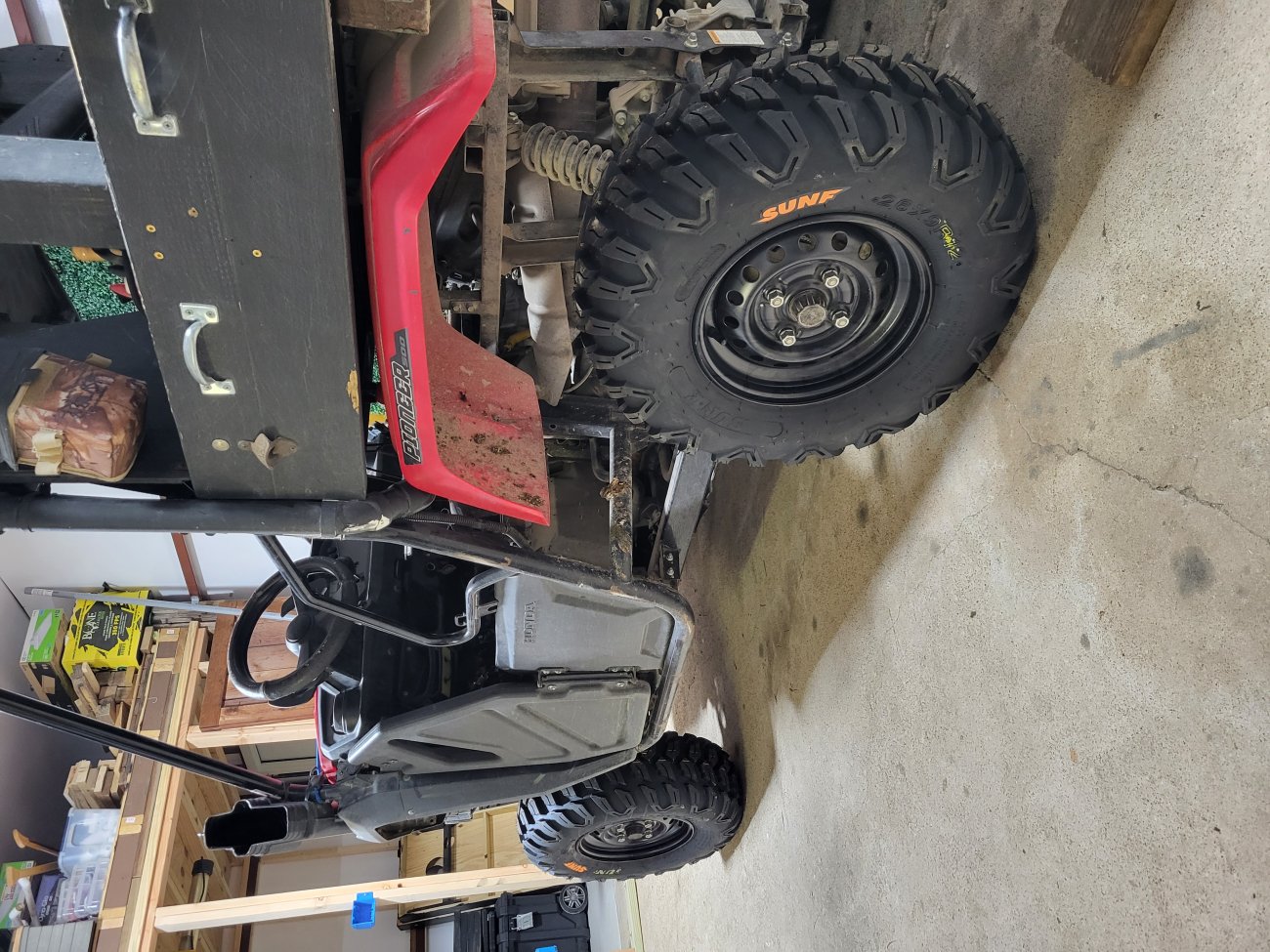

Got the tires mounted on the wheels and on Pockets. Without spacers front outside to outside is about 49 1/4" and rear is 48".
So if I put 1" on the front and the 1 1/2" on the back ill be around 51 1/4" in the front and around 51" in back.
Or put 1" on the rear and the back would be about 3/4" wider. Hmmm, what to do? Order wider spacers?
Edit: not sure why the pic is sideways?
What are Pockets? How tall are those tires, 26's? I'd go with the wider stance based on the measurements you've given, otherwise it'll be a puckerfest.

Ok, will definitely go wide.
