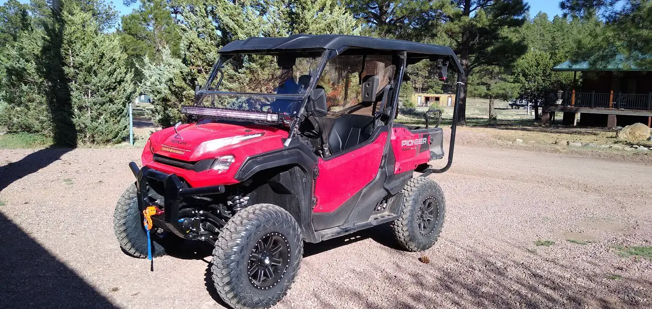

Well now I can confirm that Tusk terabytes 29x9x14 on 4-3 offset will not rub in front at full lock left or right on a stock 23 Honda pioneer 1000-5. I put the same size on the back and really see no need for a spacer.
yes that right sitting on flat ground they dont but what about ridding? trails and bumps. no tire rub on floorboards?

I live in the mountains and will put about 40 miles on it today so I'll let everyone know
29” silver backs on the 16 rubbed when running 25-30mph hitting bumps / whoops out at river ranch Fl. I haven’t road any hard trails in Va with my 2020 p1k5 with TTC 3 lift but i have road it hard as you can in Fl and bottoming out and not rub. So now all the familys new 2022 p1k have TTC LIFTS on them. 30” supper swamppers no rub an i run 30 OL2 and 30” carnivores on 2020p1k.

Did 40 miles yesterday. I did get them to rub, but only at full turn hitting a bump. I actually had to make it rub. During normal driving conditions I didn't notice any rubbing at all. However don't ride too close to me cuz these are some rock throwing tires.
