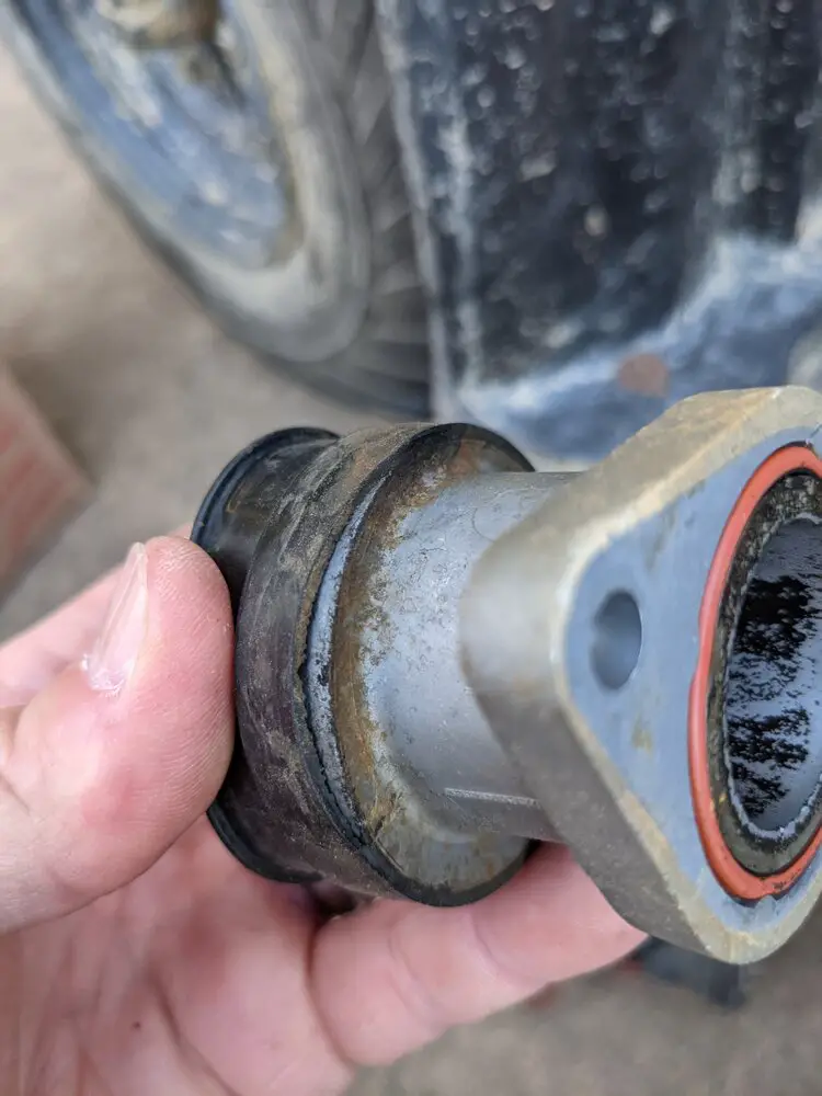

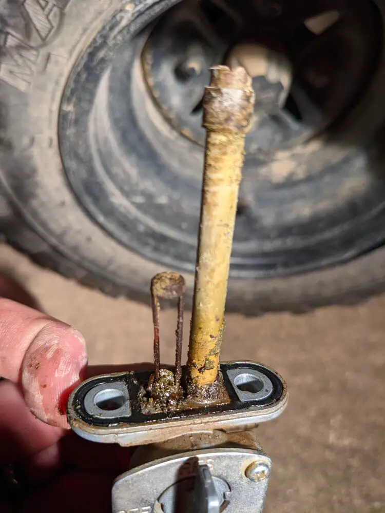

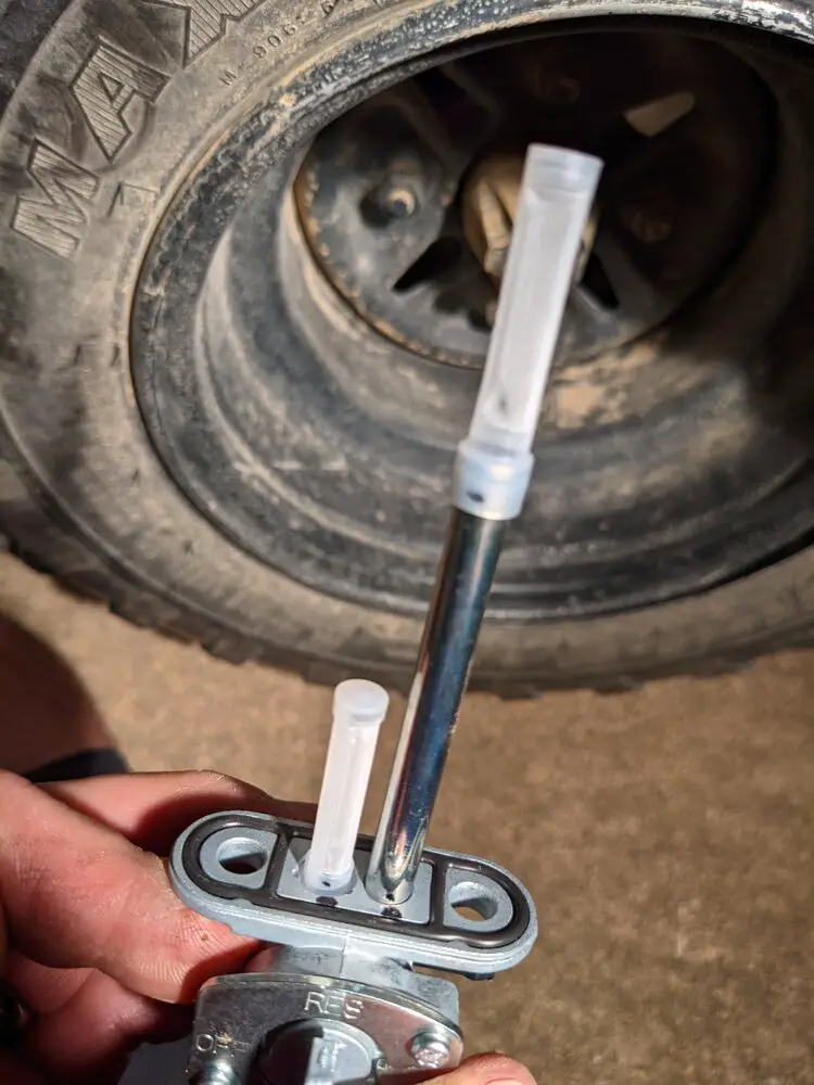

Update: the intake boot did indeed have a tear in it. See pic.
I also changed the fuel shutoff valve, as the old one didn't work. The old one was halfway dissolved, was covered in gunk, and no longer had the screens. I'm going to rinse out the fuel tank too.
Thanks for all the suggestions! Really appreciate the assistance!
View attachment 289145 View attachment 289146 View attachment 289147
Judging from pics, you may have gotten debris in the jet passages of the new carb.

It's not running yet. I still have the thing apart. I'm going to flush the tank before I put it all back together.
