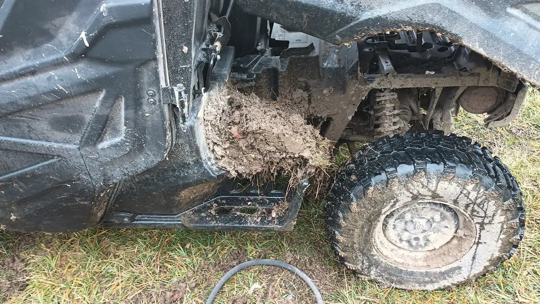

Looking into some mud/cow poop protection for my 1000-6 and haven’t had much luck with finding pictures. Seems like there’s a bunch of nooks and crannies to pack mud and poop into that may be a pita to clean come spring. I’ve found the mud busters, which look pretty decent maybe? Can’t find a picture of a 1000-6 with them installed and labeled if they are the standard or xl’s. Also found some super atv front inner fender things but they look like they would hold mud behind them and are more of a stick guard. I was hoping to find an inner fender/flare with a rally armour style mud flap. Anyone have any other ideas or pictures that might help me?

Mudbusers like most fender flares are just going to keep stuff from being flung up/out and covering you and passengers
They don't really stop anything from packing into the fender wells.

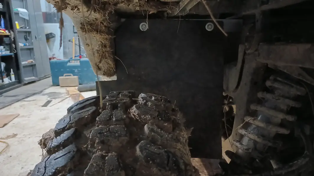

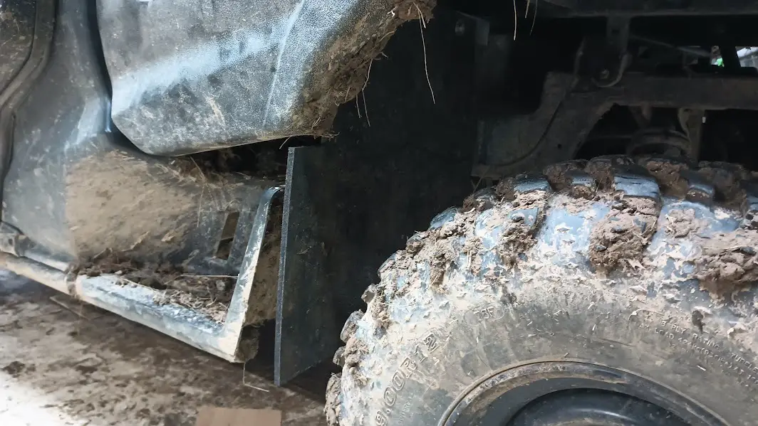

I made these out of belting. They work great. No more of this mud build up after I installed them. I farm and used them most of last year and there still on and work good.

I also used old gravel stacker conveyor belting on the rear of mine. Def not pretty but it does the job.

genius. where did you source the belting? i was considering similar up front against the firewall/floorboards to prevent stick intrusion. would take a lot to jam a pointy stick through that.
I got it from a buddy at the power plant but you could just buy the heavy duty big truck mud flaps. I used a piece of aluminum angle to mount to the underside of bed with self tapping screws and then bolt the mud flap on.
