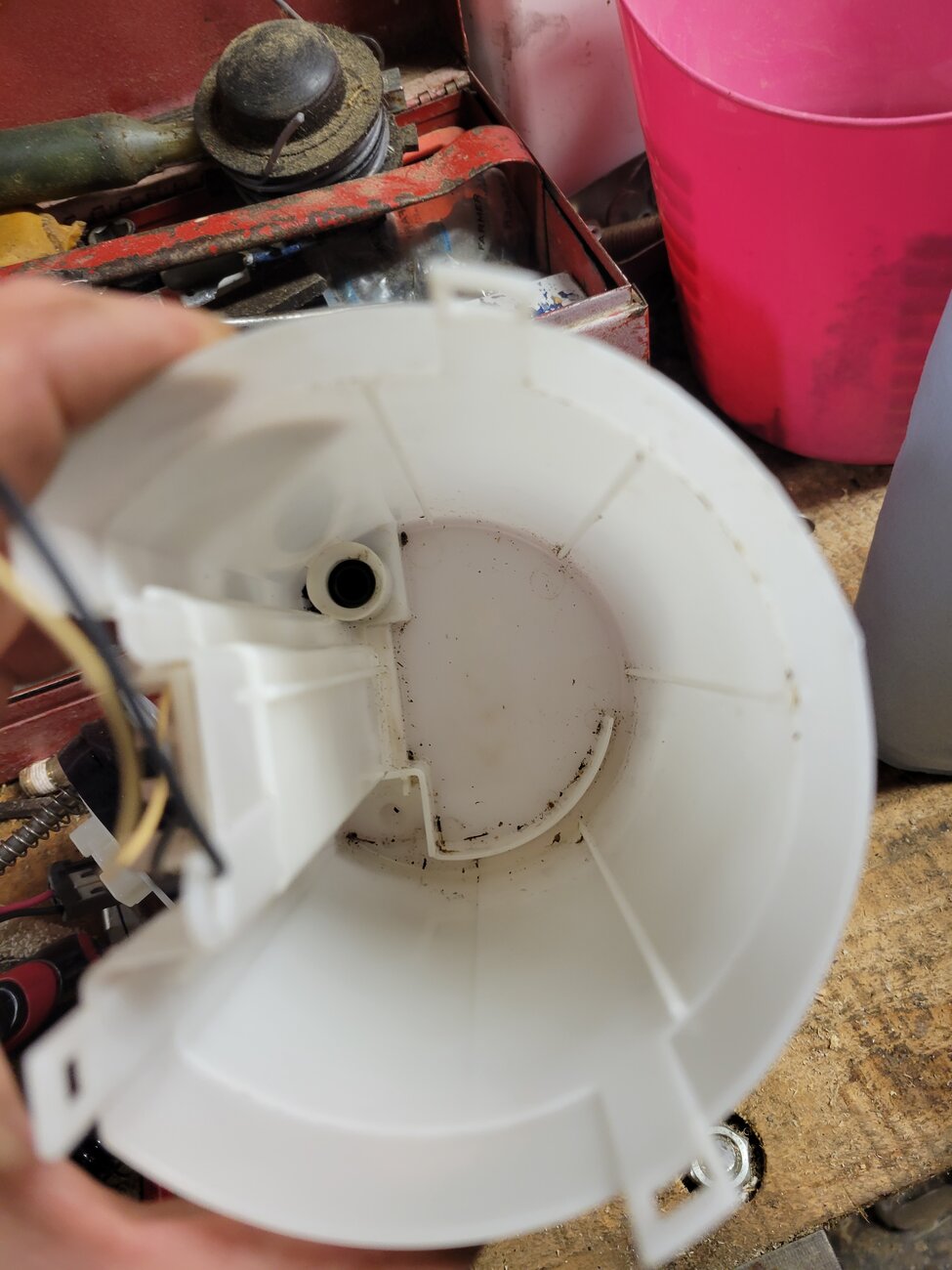

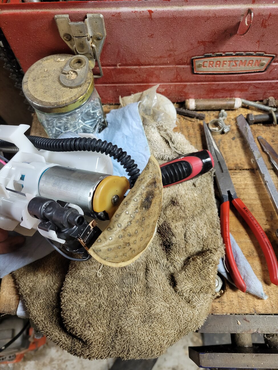

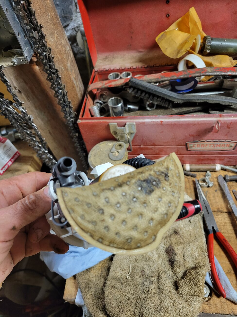

Hey Guys,
I've had some intermittent no start issues, sputtering, lack of power, etc. Local Honda shop recommended pulling the fuel filter. So here we are. Not totally clogged but not pristine clean either. Does anyone know how to remove the brass looking strainer?
I've come this far, I may as well put in a new one. Thanks All

The sock should pop off, maybe twist off.
The inner filter in the bottom isn't removable without replacing the whole assembly
