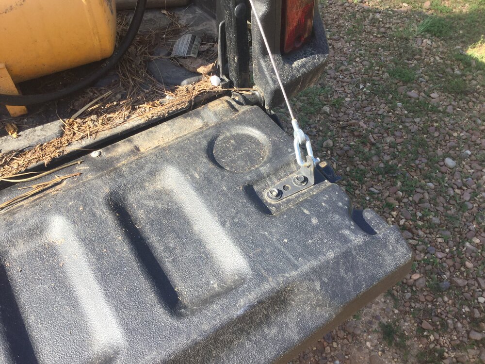

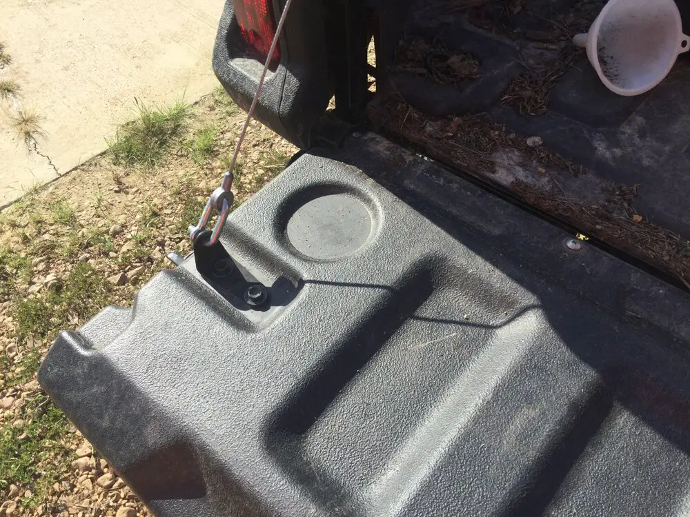

My P1K does not have a crappy tailgate since I spent a couple dollars on two shunts from TS.

Here you go @FlipKing .

Mopower any pics?
