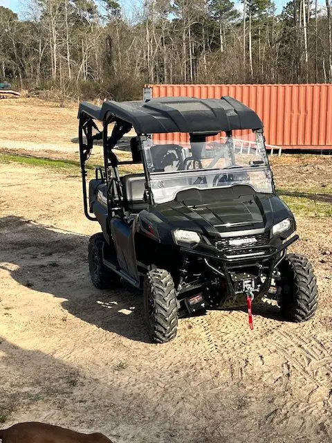

Hey guys, I just recently bought my first SxS, the P700-4 and one of the accessories I find necessary is a snorkel. I live near the Ouachita Mountains in central Arkansas and already have encountered high water spots when crossing river/creeks. My question is, is it worth spending the money on a snorkel kit or do most of you go out to the hardware store and buy PVC and DIY?? If done correctly, I can't see how doing it yourself with PVC could go wrong. Are the kits more appealing to the eye? Also how deep have you gotten without a snorkel?! Let me know your thoughts!
