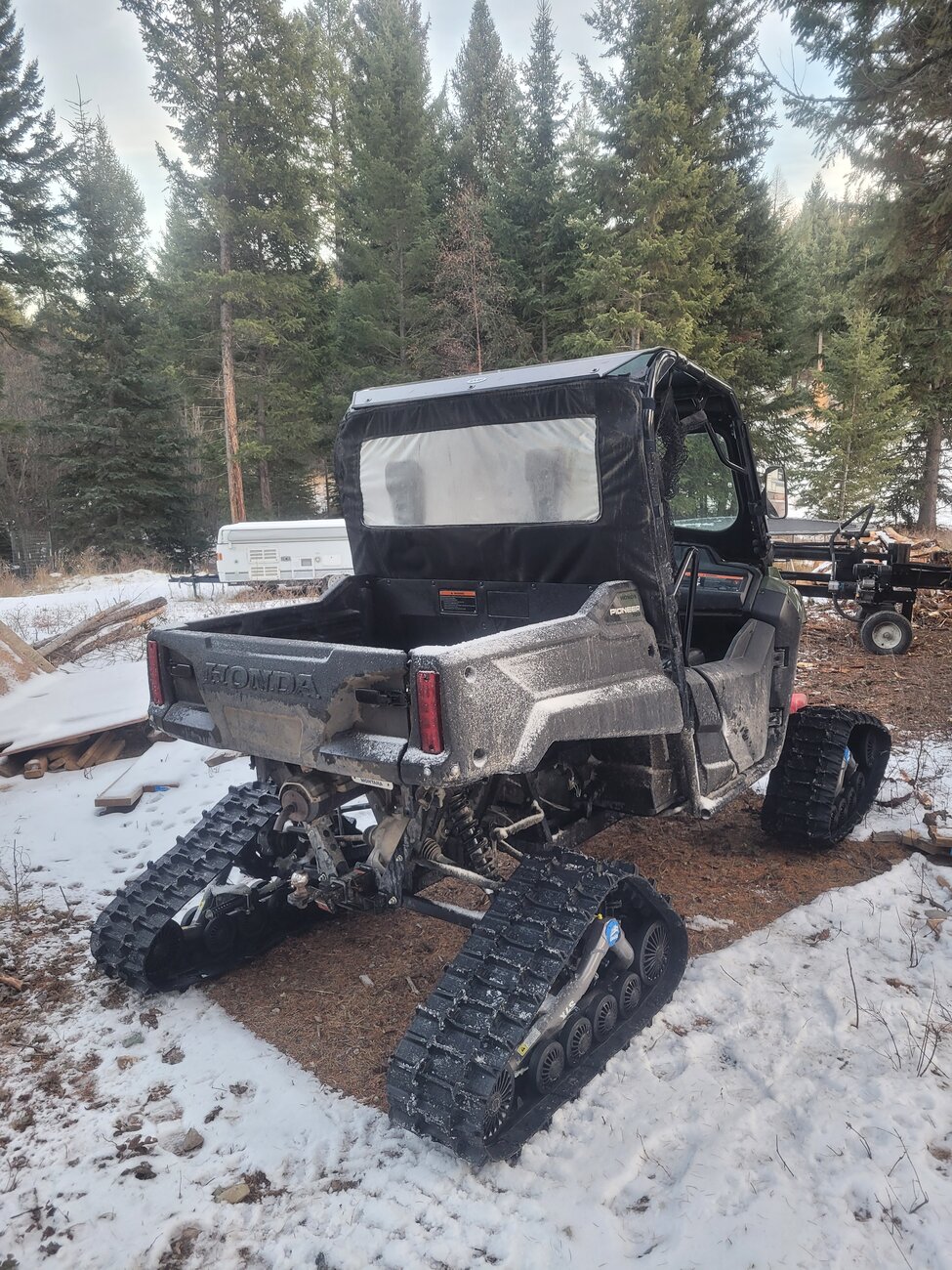

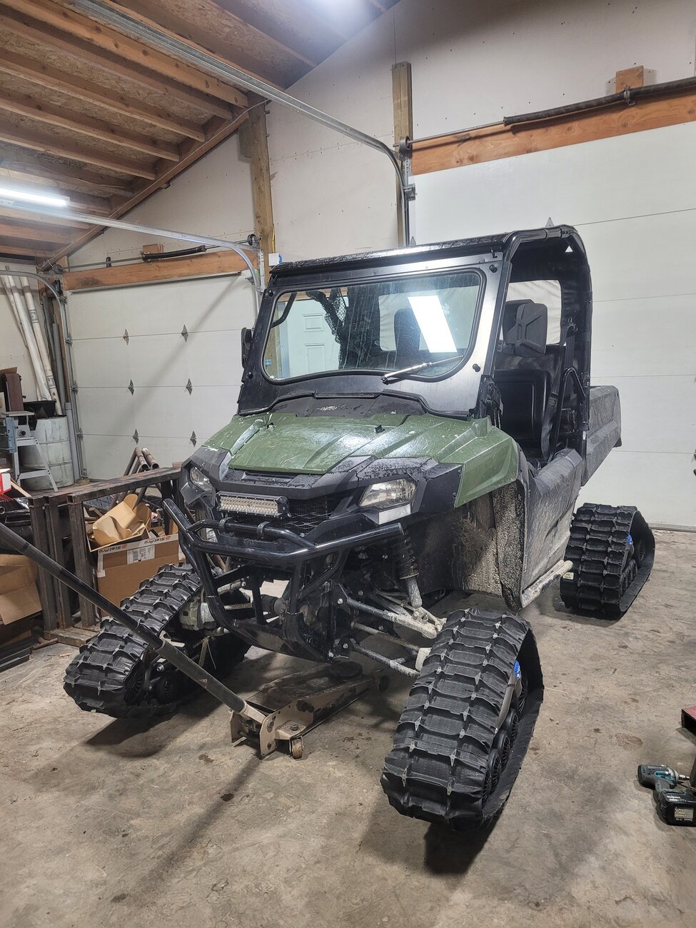

Update on my P700, i finally got my x4s tracks installed. They seem great, but cut the speed almost in half. When my speedometer says 39mph im only going 22. It cruises at 14-15 now, basically like being in low range. Now we just need some snow...

Tracks and fluffy -10f powder conditions basically turn the stock intake into a snow vacuum.
It was losing power and eventually wouldn't go more than 12mph or shift out of first gear. When i stopped it died...like 6 miles behind a locked gate. I unloading all my trapping stuff and popped open the airbox and found the problem.
i can't believe how hard that snow was packed in there and that it could run at all.
I ended up putting a gallon ziplock over the air intake, so it could only suck from the cab side andput my backpack on it to reduce the snow sucking.
I need a in cab snorkle.
