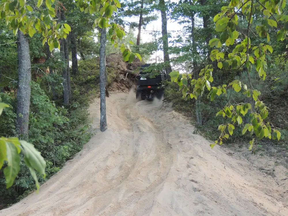

Letting off on a down shift isn't always necessary either. Climbed a sand hill that others couldn't make, @PistonHonda witnessed it. One was a Ranger and the other a P5. Hit the base of it in 3rd, half way up she just started to bog and hammered 2nd without ever letting off the throttle. Clunked hard and was high rpm's for a second or two, then powered its way to the top. You'll play hell to hurt this machine's drive train.
Never figured out why the other P5 didn't make it, could've been the tires, extra weight of lawn chairs he was carrying, or just the driver's capabilities. :p
The Hill THE HILL! :D
View attachment 65650 THE HILL! :D
I saw the same thing... pretty sure it was the lawn chairs.
