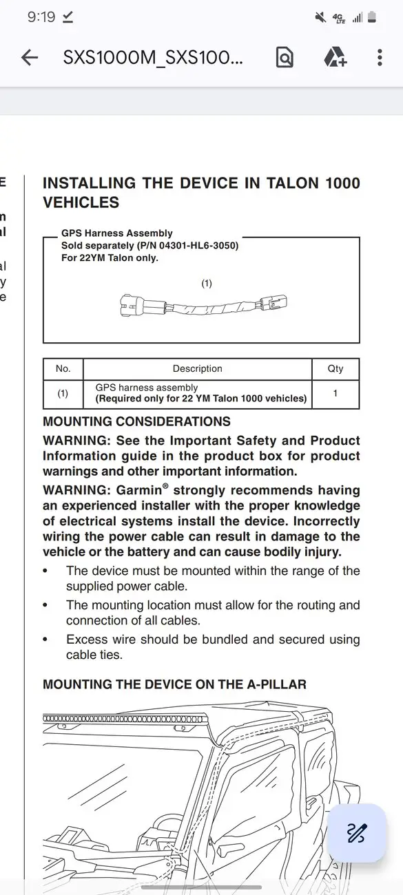

For what it's worth the GPS instructions say you need a pigtail harness for 2022 models only.
I seen that item.
So that tells me the 2022 was in fact mis-wired at factory.
The update makes it the same as the 700.
Kool.
