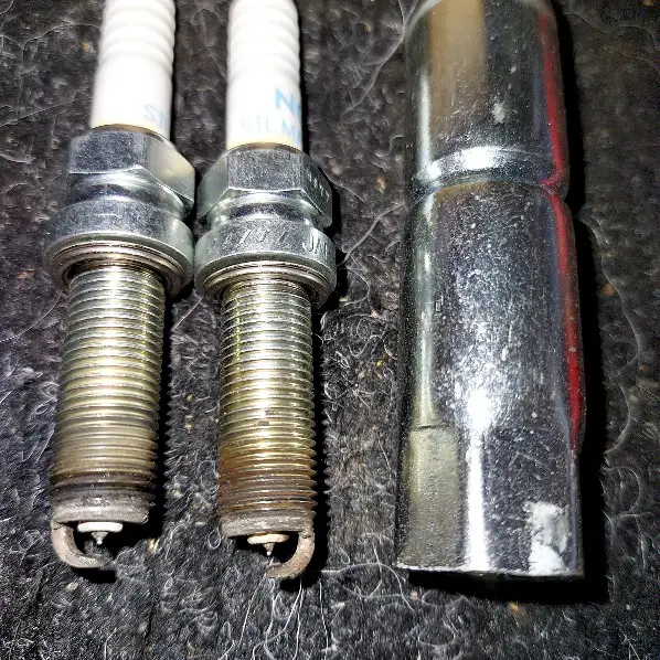

I was too busy riding or I would have checked the valves at 20,000 miles. My engine still runs great, and the valves were not noisy. Intake Spec is .006” + or minus .001” and exhaust is .009” + or minus .001”. All the intake valves were perfect at .006”. The exhaust valves needed adjusting. One was ok at .009”, two were in spec at .008” and one was out of spec and .007”. Fortunately, it's easy to adjust the exhaust valves.
The spark plugs were still like new. I had new plugs, so I installed them. The spark plug caps are difficult to remove if you don't have gorilla strength. The spark plug socket in the tool kit makes removing the spark plugs easy. There was a lot of disassembly to make it easy to do the adjustment. I clean everything up before reassembly and did a good wash job before I took it apart. I put a large plastic gas can on the passenger seat area to lay on so I wouldn’t strain my back. I used a small mattress in the bed to lay on. I have been careful to avoid straining my back for the last ten years.

SparkPlugs17482Miles

Those plugs do look good for that many miles. Thanks for sharing.
I just ordered a of plugs for my trail toolbox. I hope I never need them.
Needed them for the Pioneer at around 3k miles, but that's running an aftermarket tune as well. I keep two in the Talon all the time now.
