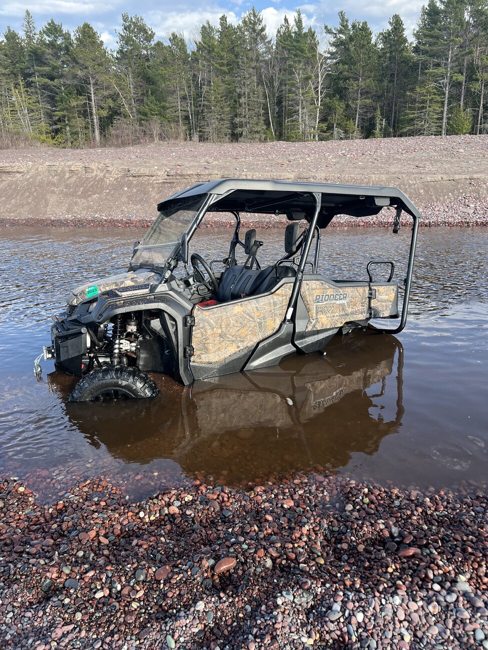

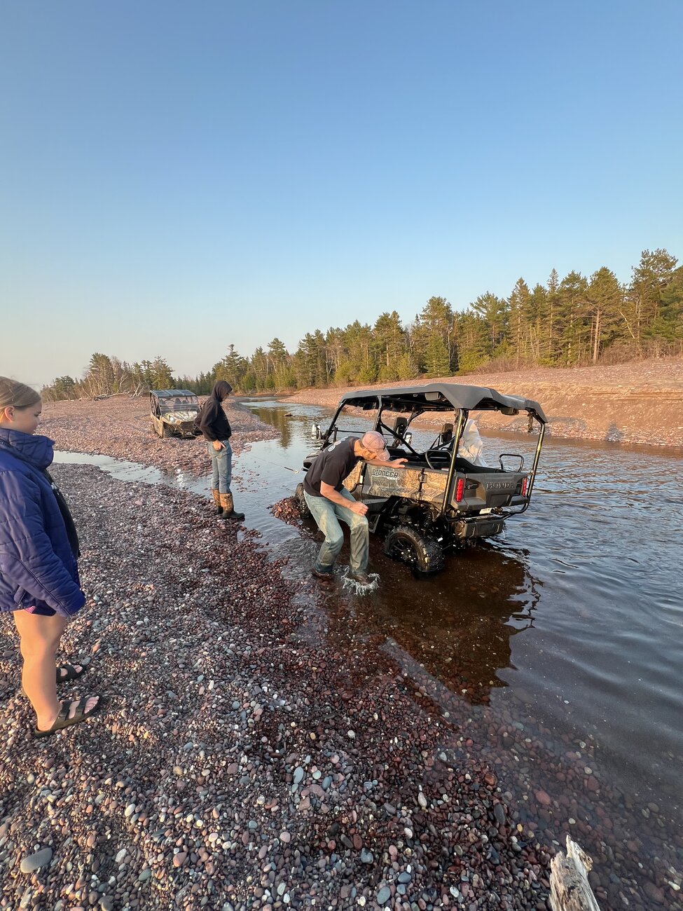

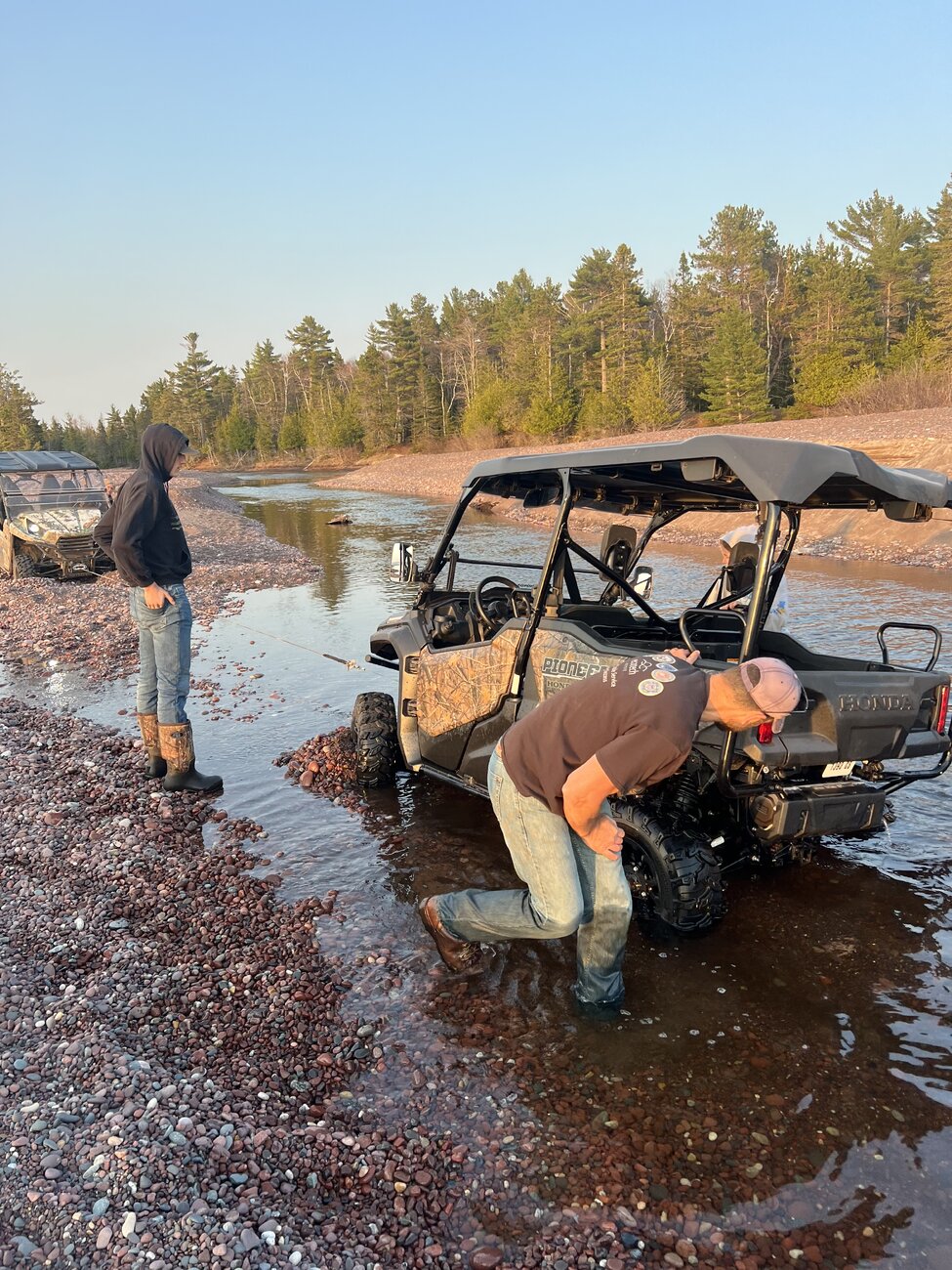

First here are a couple pics. I cannot get the videos to load because they were taken on an iPhone and the video is not compatible to this site. Finally got it running. Rough idle. I believe still has some water in the exhaust. Possibly water in fuel line. I took out the tank and dumped it and put fresh gas in. Rear differential and sub trans full of water. Engine oil clean. Still need to check front differential.

First here are a couple pics. I cannot get the videos to load because they were taken on an iPhone and the video is not compatible to this site. Finally got it running. Rough idle. I believe still has some water in the exhaust. Possibly water in fuel line. I took out the tank and dumped it and put fresh gas in. Rear differential and sub trans full of water. Engine oil clean. Still need to check front differential. View attachment 468615View attachment 468616View attachment 468616View attachment 468617
