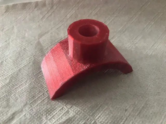

I made one of these and just now using it to install a back up camera.
Wondered if anyone here would like one or if I am just biased because I made it.
If you don't like the poll choices, please give me some feedback.
It has a 3/8 hole thru it to guide a drill bit so you stay dead center on the ROPS tubing.
It is 1" wide so you can mark 1/2" off center of where you want to drill a hole
If you install the drill bushing, this one I have drills for a 1/4" drill.

Thats very sharp. I have something similar I've been using for a while (mainly on stair railings and such). Thats a great tool.

Well, I am the dumba55 for not thinking to explain what it does. I edited the original post to fix that. thanks-
I struggled with another project and one time in particular, I pulled hard on the trigger and the bit zipped about 2" across the tubing and left a nice scar that I had to repaint. So, thought I would do this.
I also know that while this is an original for me, somone else or some company may already have something very similar already. Wondering anyone has seen one before.
