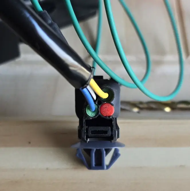

@Hondasxs Yea I understand, was just saying with the bulb swap the high low difference is less noticeable.
My connector looks to match the one above. Thanks

The switch does not power the lights. It's job is to power the relays. So affecting power draw shouldn't be a issue.
This should be the proper pin layout.
For those of us with the incorrect pin layout, do you have any advice on swapping? I can't seem to figure out how to get this pins out, and I'd hate to break one trying.
Thanks

Here is info on it.
I can also send a return label.
Dont be afraid to give the re-pin a try. I can fix it.

Thanks for the quick response. I'll give it a go.
