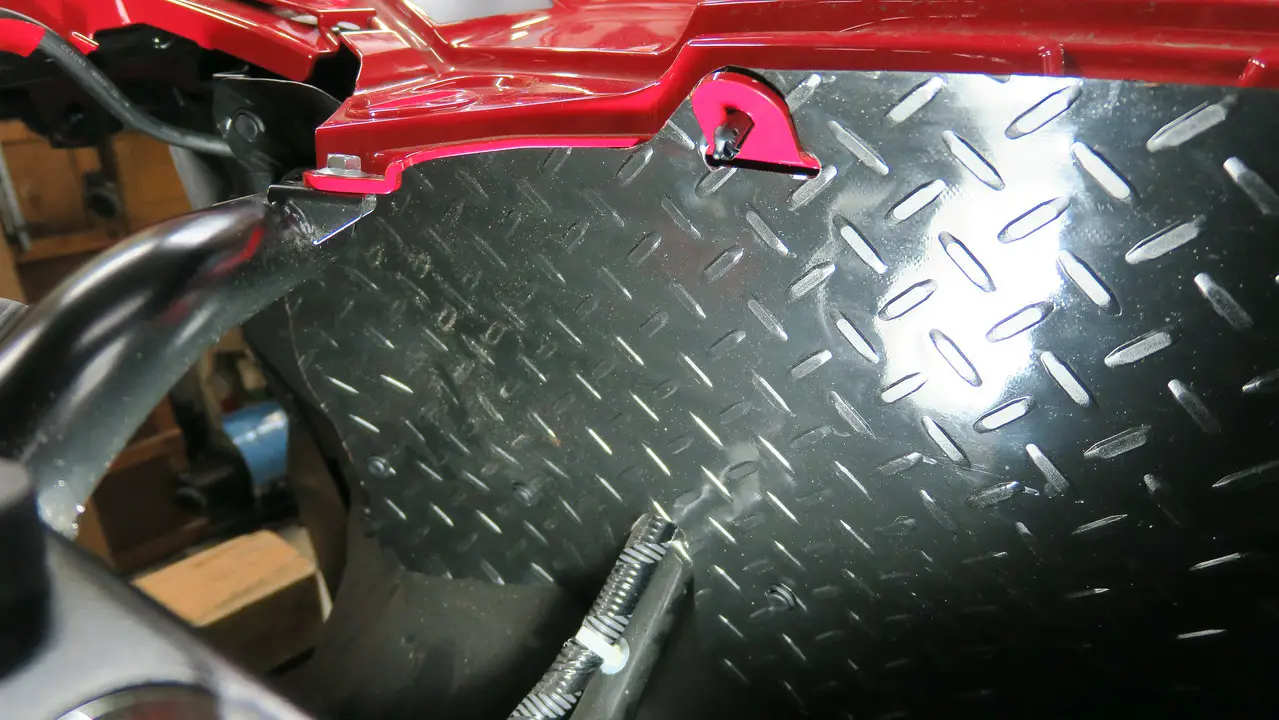

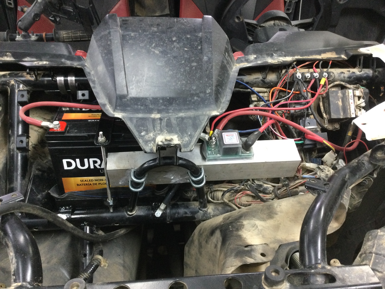

There's a popular aftermarket battery tray for the Talon that mounts it right behind the radiator. :oops: After someone smart mentioned exactly what you just said, I made my own battery tray, mounting it behind the plastic firewall, as protected from the heat as possible.
Sorry for the Talon content - 😊
This -
I ZzPkkkm X2
is hiding behind this -
This -
