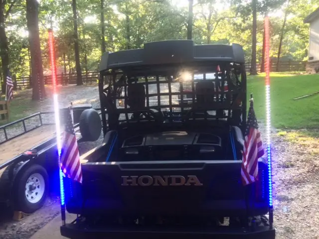

Hopefully it will show up in this picture..it not out there much, but it is a few inches more than stock...you can always get a short extension for your receiver hitch if it is a problem with your trailer...but I don't think it will be..
