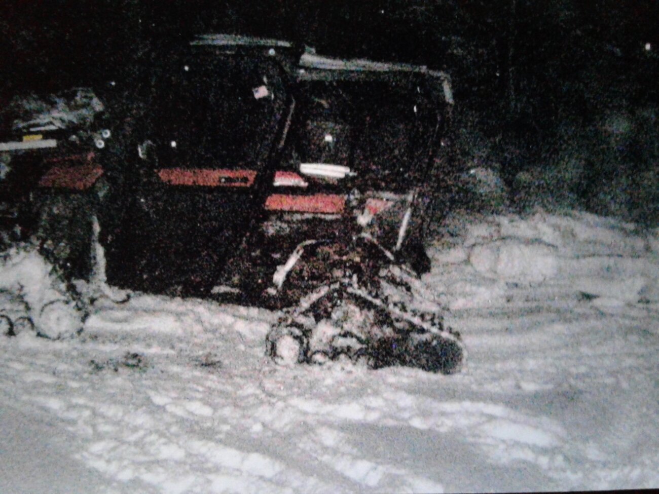

Mine were New in box originally purchsaed for 2014 Can-Am Maveric 1000
I called Camso explained my project they gave the part number to tell dealer ( Required Sprocket change to accommodate 1000cc to 700cc )
Fit Kit to P700 was $550.00 in 2014 <> inc ship & tax
2018 put those Tracks on 2018 P500 -- fit kit was $650.00 <> inc. ship & tax
In my case both kits came with sprockets needed along with <> A-arm & Anti- Rotation hardware.
FYI: 1-No need for sprocket change P500 & P700 ( per Camso )
2- With Tracks <> Best ot Snorkle the Air Inlet up & away from OEM location.
3- Open up Exhaust Outlet for better midrange pulling.
4- If you donot already have a Enclosed Cab ( you will soon find the need ) or be in waist Deep snow in the seat.

View attachment 378114 View attachment 378115
That's where I lucked out with the tracks I found, the sprockets were the same for the Rhino 660/700 as the P5, all I needed were the A-arm brackets
