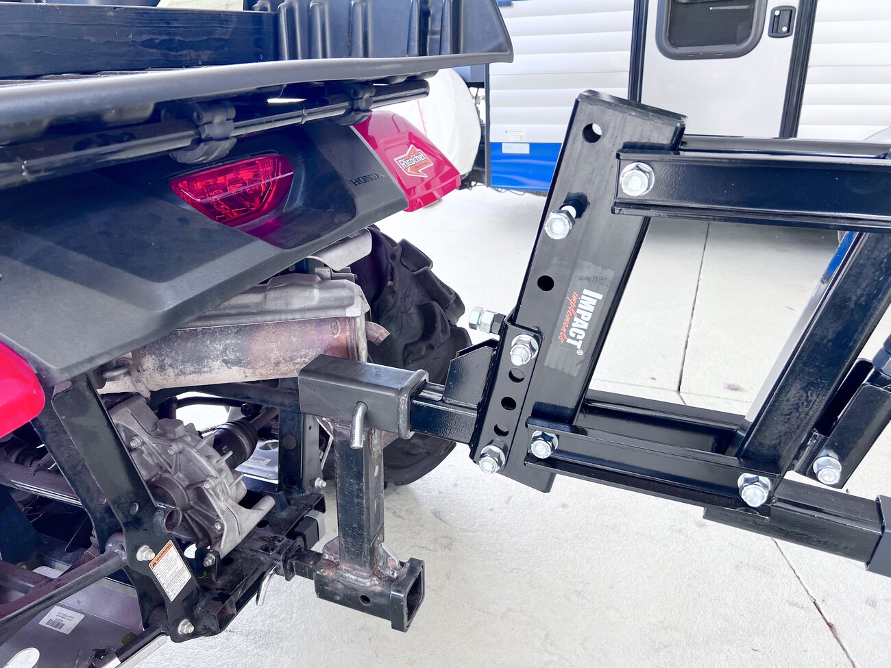

I put one on a 2021. Straight bolt on, though some have reported having to drill out a hole or two a bit larger. I struggled with the install on my 2018 P500.

I did not have any issues with the Moose hitch hitting the gear box on my 2015 P500. I did have to open up the holes in the hitch to get all of the bolts to go through. I do need to trim some of the back of my Curt D Ring shackle since it does hit the gear box and prevents me from having the d ring parallel to the ground plunger I can't get the hitch pin either. The Curt works fine if I turn it 90 degrees though.

My wife gave me the Moose 2" receiver hitch for Christmas. I finally got around to installing it today. Straightforward installation except for 2 things:
As others have mentioned, there was a little fin sticking off the back of the gearbox housing that hit the forward edge of the receiver tube. I had to give it a slight touch with the grinder to get things to fit.
IMG 3884
I also found that the two upper mounting holes on the hitch assembly were drilled too close together. They probably needed to be just under 1/8" further apart in order to just barely be able to get the bolts through. A few minutes with a carbide burr bit in a cordless drill and I slotted the holes in the frame inward a bit, and took the holes in the hitch outward a bit, and it bolted up fine.
The lower two holes were snug, but I was able to get the bolts in without modification. My recollection is that these lower hitch holes were also just a hair too close together, but I did not pay a lot of attention to that, since they went in.
