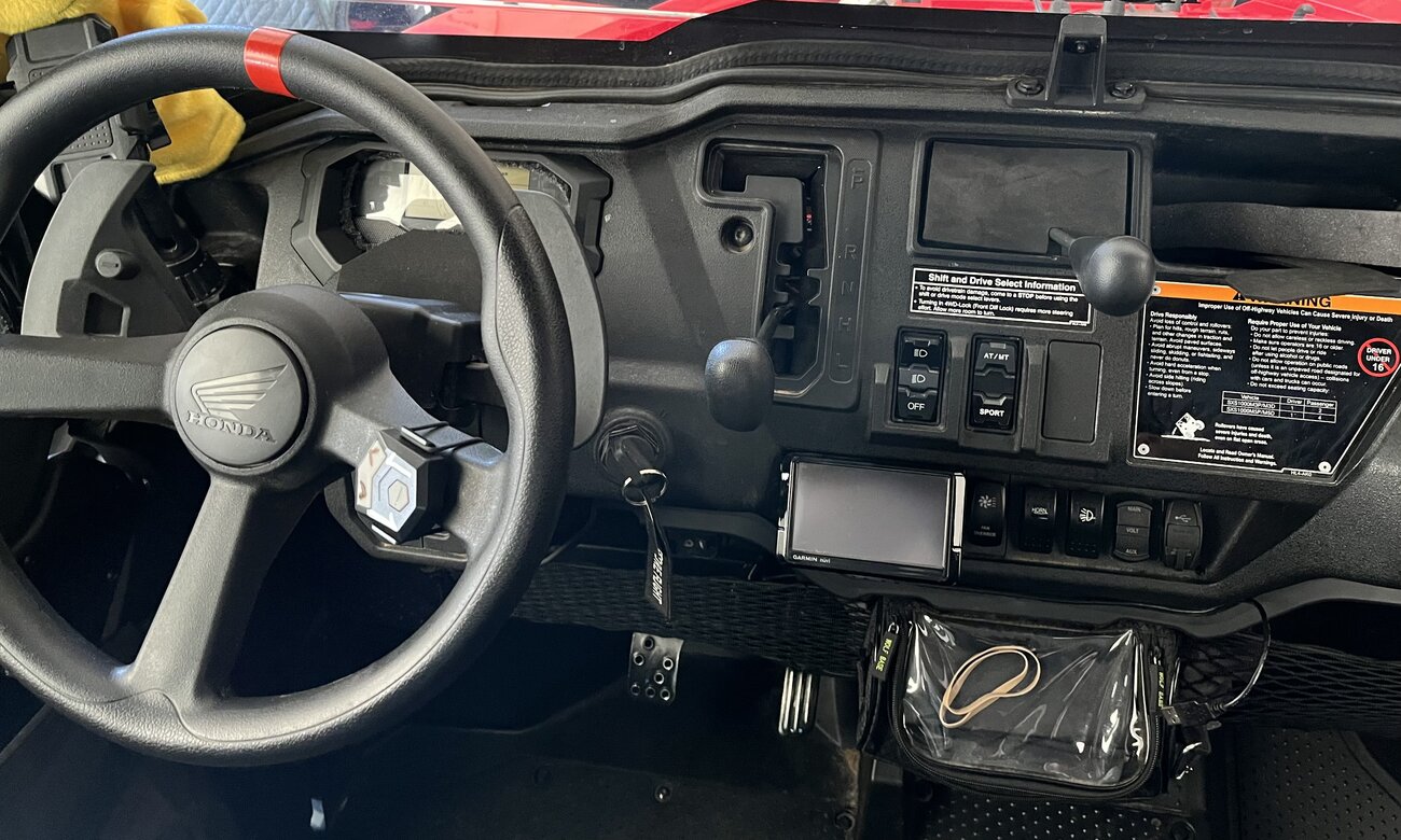

My 2022 Trail has the same issue. There is about a 3/16" gap between the gauge cluster and the dash. When it is cold out that air blasts you right in the face. My not so elegant fix was to put 1/2" wide butyl tape around the cluster to block the air. The right way would be to remove the dash and fix the reason why the cluster doesn't seat against the dash opening.
I’m glad I’m not the only one, and thanks for showing what you did. As I suspected, it’s just not a well known issue yet, ergo not something one would find in a search or fifty. Glad you’re also turning yours into a jeep, and not just settling for bundling up and enjoying that cold blast. I actually tried stuffing 1/4” backerod in there a couple nights ago, and it disappeared into the abyss. My next move was some kind of seal as you’ve done, but I was looking for something clear. I’m trying to avoid removing the dash, but if I ever get an under hood heater, I’ll maybe address the issue, from the back, while I have the front removed. Nice looking Pioneep!

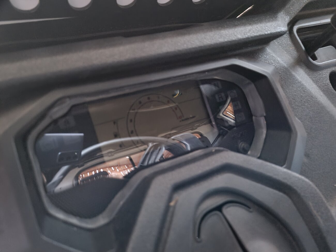

I was gone last week, I just got back and looked. I have about an 1/8" gap. I'm thinking that I will do the same thing as Bighat and use some crystal clear silicone. I think I'll mask of the instrument cluster and fill the hole. I was looking under the hood, I'm going to try to hang some thin rubber sheet from the underside of the cowl to keep the air from rushing in around the shifter. I'll post pictures if it is successful

I did mine today with crystal clear silicone. I taped off the instrument cluster and packed the gap full of silicone. I figure there is enough dust in there that it will separate easily enough if I need to get it apart later. It makes a big difference! I don't need my gloves on now when I drive.
