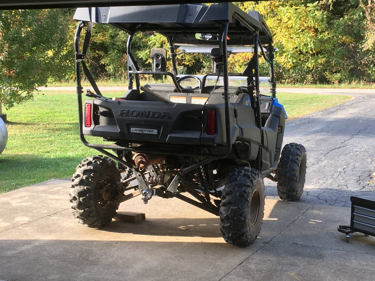

Not a new member but for some reason the site is saying I am lmao. But hello everyone! 😂. Yeah she’s got 2.5” highlifter lift, 28x10x12 Itp blackwater evo’s, 2” billet dune gear spacers, offset wheels, split windshield, memphis sound bar, a couple of light bars on the front, cab heater, working on rear pod lights and a power steering kit now. Wanting to lift it a couple more inches because of rubbing issues. Will a strong made lift work with the highlifter? To me it seems like it would. Does anyone have any experience with that?

It still was a running motor but wouldn’t start because of decompression issues upon start up. After I figured it all out I just ended up rebuilding the motor because it was all torn apart anyways. But it ended up being a bad camshaft and weak torque reducer but the motor was worn out too. So she got completely gone through with all new bearings,clutches,top end,cam,valves,springs, timing chain. The whole 9 yards. She’s like new again. Hopefully she’ll go another 9,500 for me. Fingers crossed.
