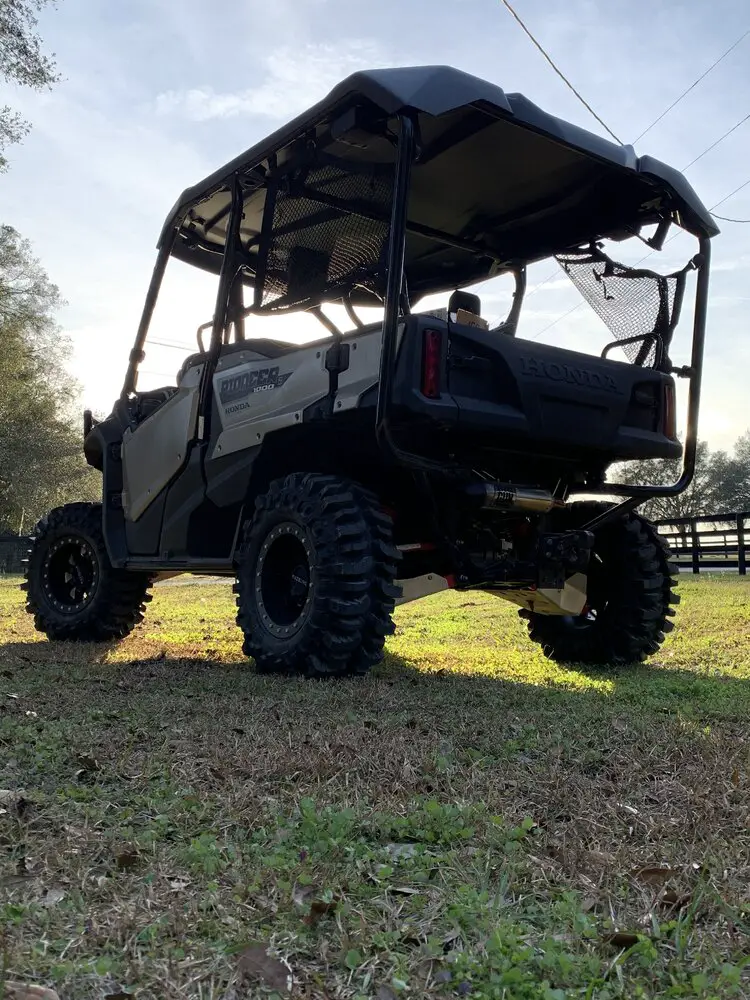

We ride a couple miles of pavement to get to our trails. I wonder how much I'd have to crank up the stereo with those vs. my Maxxis Liberty's (basically an all-terrain truck tire style.)
Honestly I’ve been driving it to work (about half mile) since yesterday and the factory bighorn 2.0s made more road noise than these do! But these are definitely a bit tougher haha just gotta break em in!

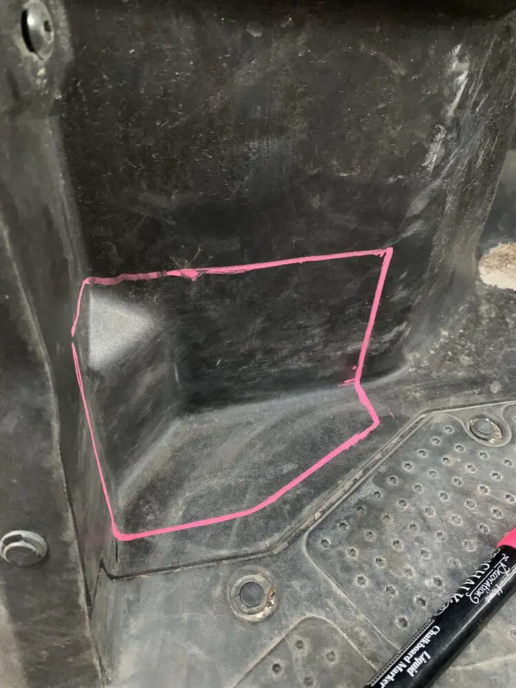

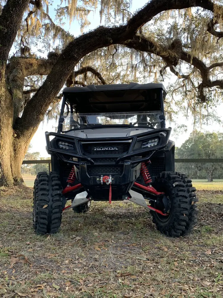

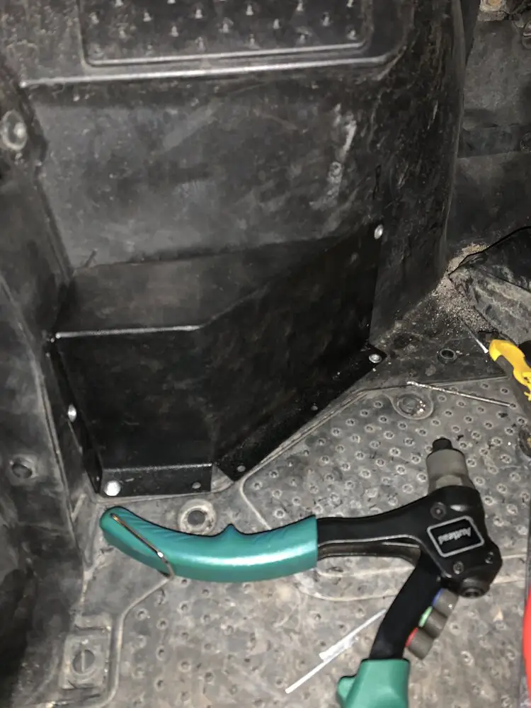

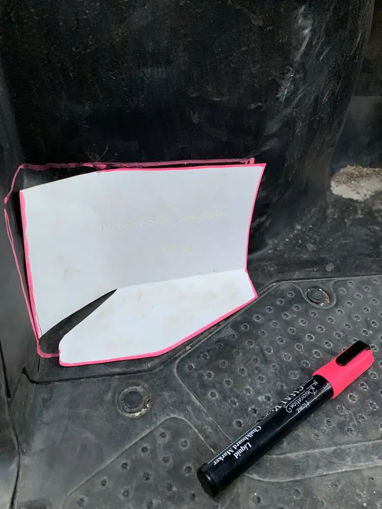

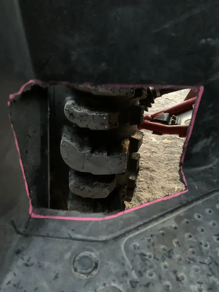

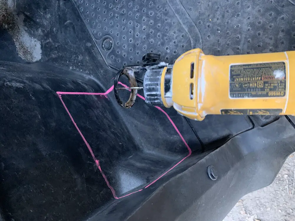

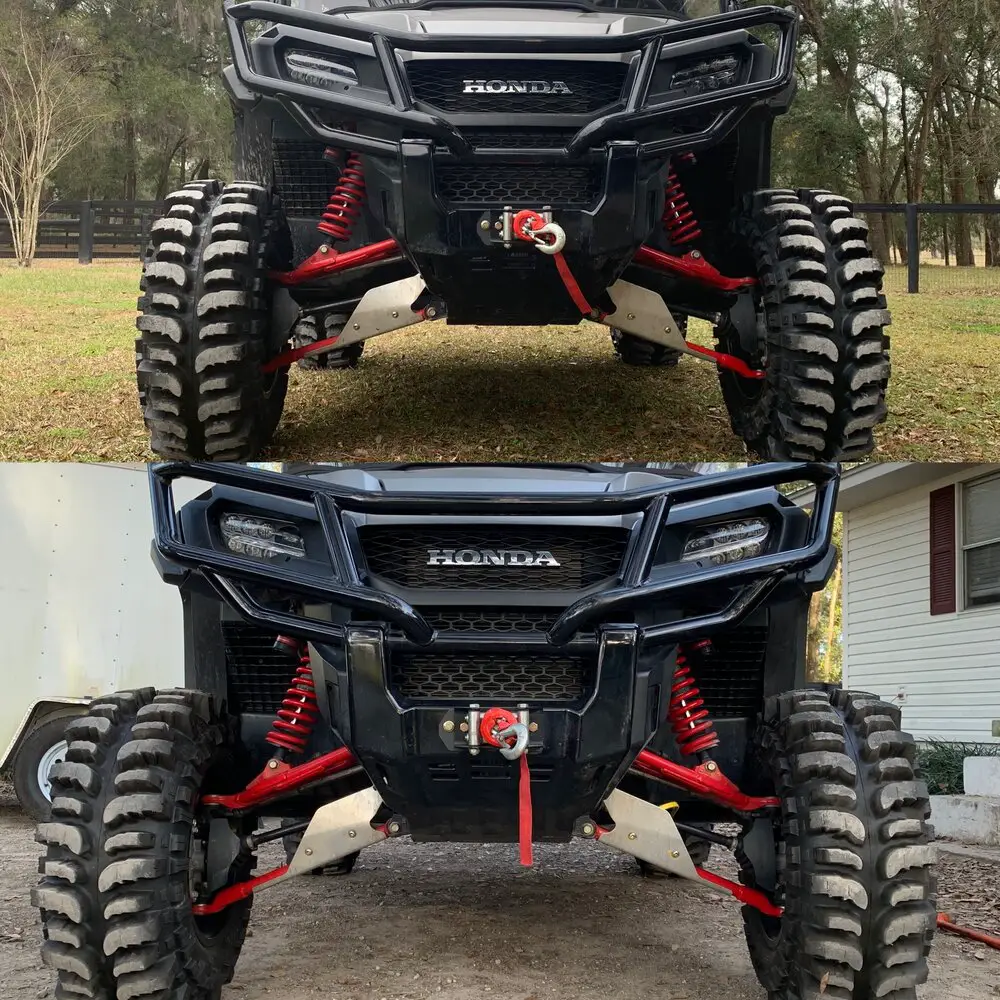

***update*** just started the floor mod install! Much easier than I anticipated and it’s looking and functioning perfectly! Full lock and full compression and zero rub! Also went ahead and raised the coilovers all the way around being I found the drivers side was about an eighth shorter on the adjustment from the factory so I cranked them all up evenly about 3/4 of an inch. Which through the control arm geometry would be roughly 1-1.5” and it’s perfect! Checked full lock axle binding and everything is free and clear. Big shoutout to trading house outdoors on the floor kit it’s a spotless clean well made kit🤟🏻Still waiting on the exhaust part to come in but I did just get my vent line extension kit and I ordered the big gun efi tuner to correct the AFRs so I’ll update again soon!!!
View attachment 250238View attachment 250239View attachment 250240View attachment 250241View attachment 250242View attachment 250243View attachment 250244View attachment 250246View attachment 250247
Looks good, is that mod pc plastic? Or metal/aluminum?
