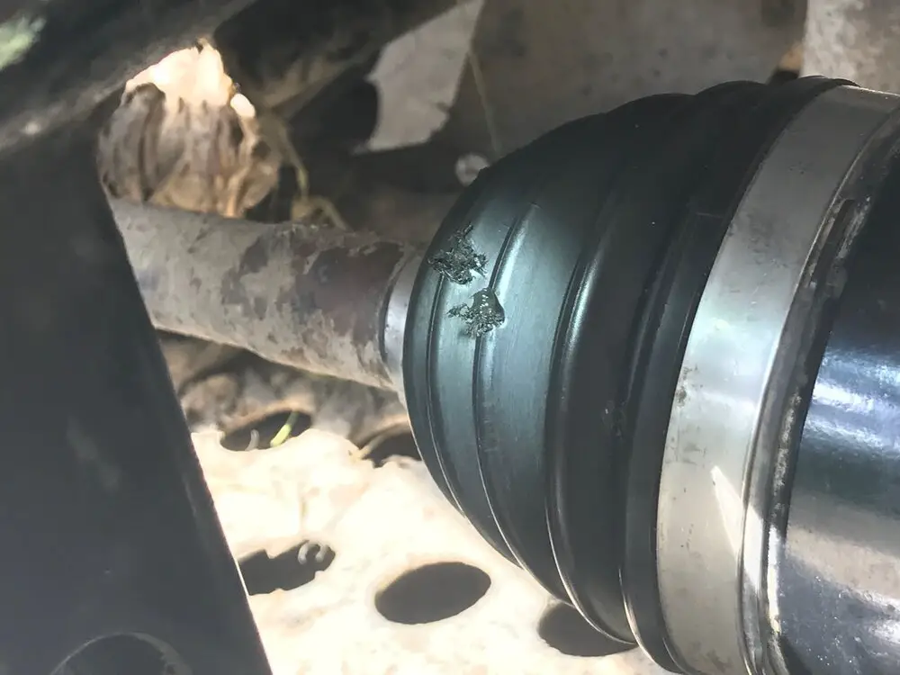

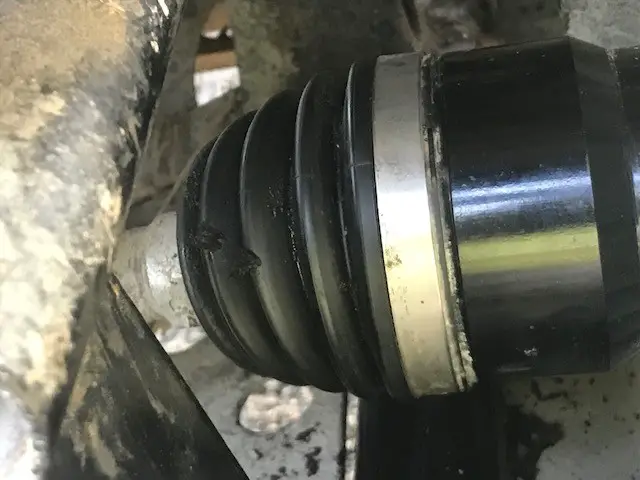

I was hooking up the boat trailer today, and noticed some "dampness" on driver rear frame. Yep, oil/grease. Inspection of boot shows some damage
I have watched a video on the front boot, and this would appear to be easier than dealing with front brakes and steering knuckles. Ordered the All Balls kit for rear inner boot. I also went thru the service manual, and didn't see anything that scared me.
Still, like to hear from those that have done it. Are there any surprises i should look out for? Hints/Tips?

Shoulda came here first . Clean it real good and coat in Shoe Goo . It should be good for a few years .

The $15 for the boot kit is nothing, compared to time to do the work.
What cleaners are recommended to remove dirt/oil without degrading the boot?

I apologize if this is already documented elsewhere, and most likely better than what I will provide, but prefer to document fixes with repair threads.
I lifted the rear and rotated the wheels to get easier access to the damaged area and such that it would not be seeping oil/grease.
I used a degreaser on a new rag to clean the damaged area. Both spots are at the top of an accordion peak. See picture.
I also posted the mfg instructions below, which recommends thin layers with minimum 3 hours between, and fully cured in 72 hours. I plan to do 3-4 layers, with a minimum of 4 hours between each. First layer has been applied.
PS: This is the clear formula, but it also comes in black, but my local hardware store didn't have it Not sure if there is any chemical difference, outside of the black would blend for a better look.

Hope it works for you too . I have read about several guys using this method and one guy said his had been holding for over 2 years BUT that could be 50 miles or 10000 miles , who knows .

Well, the 1st attempt was not successful. :(
I did three layers, but found it like to stick better to the toothpick than the boot. Fingers used to smooth out. While the 1st two coatings had many hours between, we did the ride after about 8 hours of last coat.
We took our "normal" one hour, before sunset ride, and checked it this AM. It is peeling off and grease is oozing out. It looks like all layers peeled off. I think I had too much on there and the glue could not flex to match the boot. I'm still waiting on the new boot, and will make one more attempt. I am going to "rough up" the spots with some sandpaper, like an innertube repair, and try a less is more approach to the glue.
