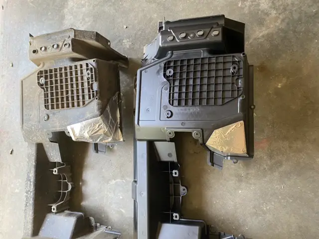

Interesting development I ordered a new floorboard and look what Honda is doing now. The one on the left is the old floorboard I took off with my fix.
8E39FBAA 9720 4796 A0DA B0134820A510
The new one shows they are now putting a heat shield in the area that burnt through. So to say this was caused by bad gas is ridiculous! Honda obviously knows there is a heat problem here.

Interesting development I ordered a new floorboard and look what Honda is doing now. The one on the left is the old floorboard I took off with my fix. View attachment 225192 The new one shows they are now putting a heat shield in the area that burnt through. So to say this was caused by bad gas is ridiculous! Honda obviously knows there is a heat problem here.
Their lawyers will argue Honda knows there may at times be a heat issue caused by the customer purchasing bad gas. To which Honda is offering a solution.
