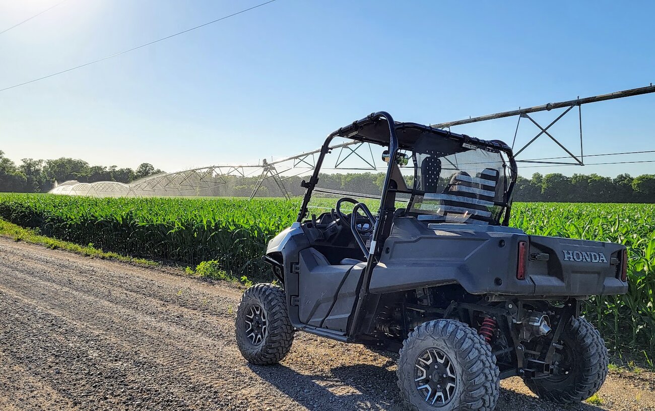

Welcome from far SW Indiana. Tusk Terrabytes are a great tire. 27" fit stock wheels and suspension with no rubbing. They are about a perfect tire for road, gravel, hard pack and sloppy wet cut corn and bean fields. I have about 3800 miles on them in this pic
