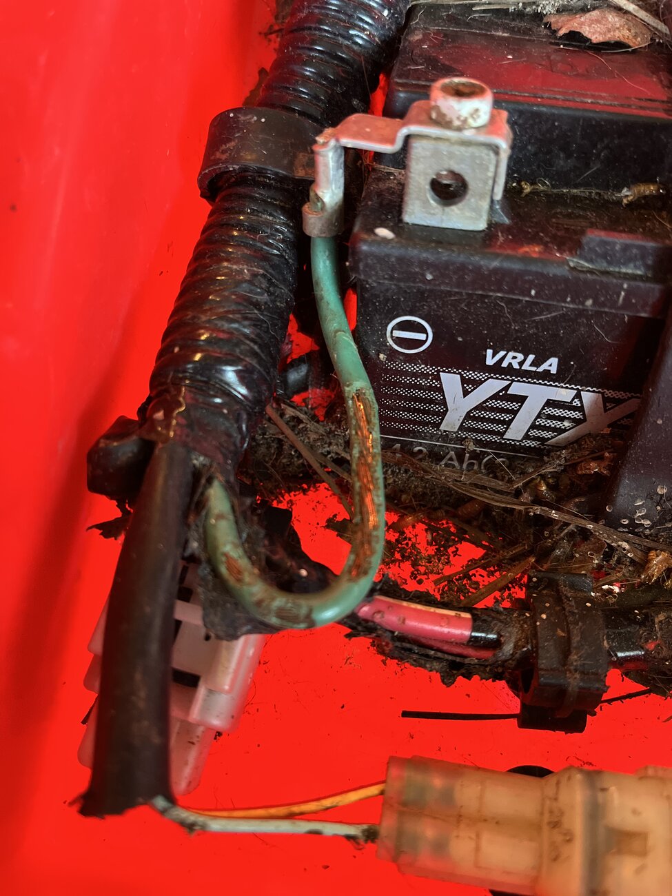

Well, I found the PROBLEMS. The culprit was a damn rat(s)!!! Gonna try to splice several wires tomorrow and get it fixed. I’ll post back how everything goes. If splicing the wires doesn’t work, I’ll have to bite the bullet and buy the $205 wiring harness. Here are 4 pics of the chewed wires under the seat!! The little s.o.b. even chewed on the rubber band battery hold down thing!!! 🤬
View attachment 314053 View attachment 314054 View attachment 314055 View attachment 314056
That always sucks when it happens. At least you figured it out and it is repairable. Bummer though regardless. 😔

Well we got’er fixed this evening! Gonna put fresh gas, install a new spark plug, clean the air filter, and change the oil to freshen it up a bit but overall it runs good! Also had to buy a new battery ($90 at O’Reilly Autoparts with a discount!!) The old one wouldn’t take a charge.
